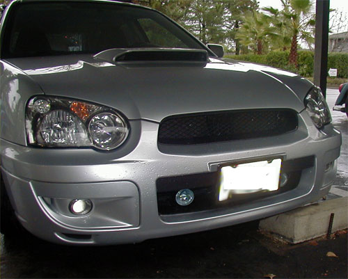

here's what it looks like
JDM STi headlamps & PIAA 1000X mounted under the bumper
