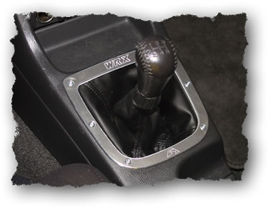

Got my ASP Trim Plate!
Well the ASP trim plate came in today...really high quality piece, very happy with it. It didn't fit flush at first because it slightly overlaps the boot where it meets the console, but a little gentle excessive force and I was able to bend it ever so slightly so it fit flush...then literally drilled pilot holes and screwed it on...took 5 minutes to put it on after I fiddled around with fitment for 15 minutes! It really looks good, especially against the Momo ****. Here's a pic:

I had to bend the plate just slightly at the middle screws (the bottom pair seen in the picture) so it would sit flush and follow the contour of the console better...and it was the tiniest bit...I was worried if I didn't that the screw would strip the plastic if I tried to snug it on too tight to get it to sit flush...worked well...
