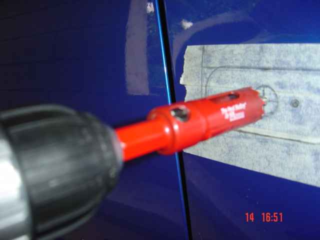

In this url ,a thread I start a couple of weeks ago,a member called Pmartell made the holes to the car .,you can find more info sending a pm to Pmartell.
https://www.i-club.com/forums/showth...threadid=45557

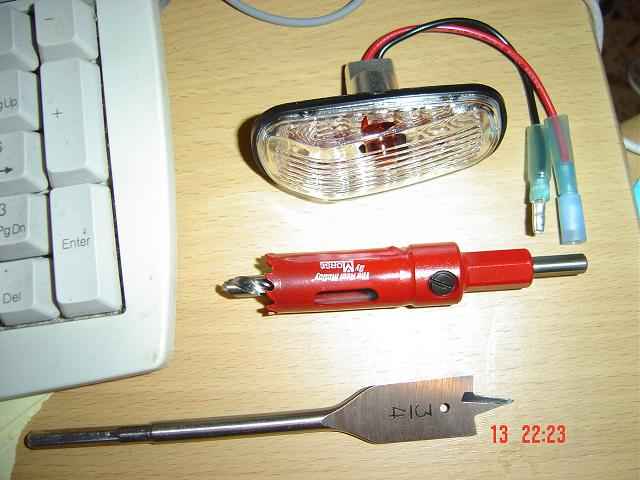

This is my next project too and I find the tools to make a good hole in the fender.

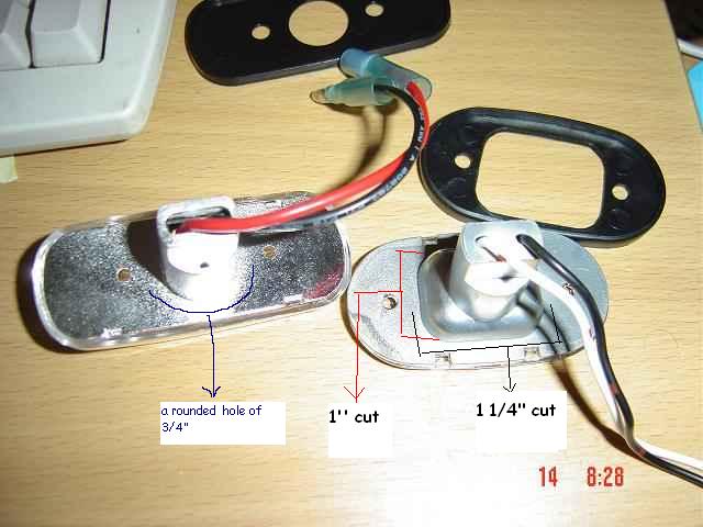

I just want to make you a warning :not all side markers are flat on the button so that's mean that you need to make a bigger hole to fix it the Sti side marker is one example and many universal side markers
I'll find pictures to show you what I mean Hold On

.................ok here again just look at the picture,compare a 3/4'' rounded hole Vs 1" x1 1/4" inches not rounded this is one the most importance feature of a side marker the web site only show the top so you can't see what's in the button of a side marker
hope this help.:banana:

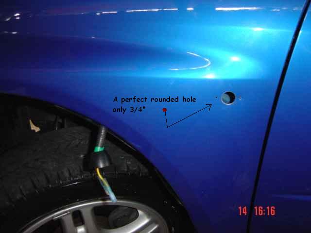

.............But if you don't want to make a bigger hole in the fender
you must use an universal side marker to get a rounded hole like the one I made

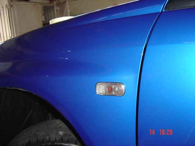

And you get this...........:banana:
