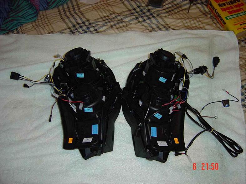

oh oh! my morettes arrive with a couple of wires and there's not instructions for the connections did anybody have the diagram for the morettes.

this is the best i can explain it, hope it helps.

I'll try this tomorrow and so that's mean that the Hi beam receive the voltage through the relay

exactly, and the area i lined in blue, should be connected also, dunno why they aren't thats a connector for the low beam.

Ok found the problem a broken wire on a relay .,the diagram is ok

strange! very strange! I found that in one of the headlamp is an additional bulb look at the picture the other one don't have it
any idea what's happening?

they all have it, no one knows why.

Yeah, I never did figure out what that bulb does. But I've rewired my Morettes so it isn't connected any more.

Also in the papers that comes with my morettes show a motor., but my morettes don't have this motor

That's a leveling motor, it's not included in the US version of the Morettes. You really don't need it, and if it was there you'd have to do a lot of extra wiring to make it work.

All the leveling motor does is allow you to adjust the vertical aiming of the low beams from inside the car, to compensate for changing weight loads. It's not that big a deal. The JDM STi HID lights and the EDM STi lights have leveling motors built in but most people don't bother to hook them up because it's a lot of work. You need to get or fabricate a harness, and you also need to get the switch.
The US '04 STi has leveling motors for the HIDs, I believe it's a DOT requirement for OEM HIDs.
