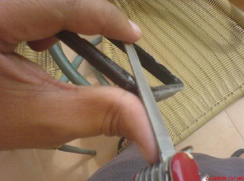

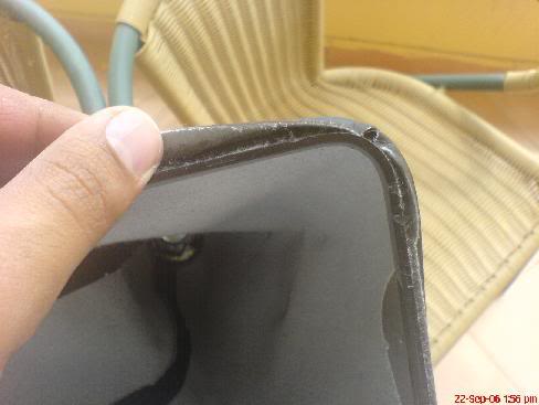

Third remove the leather from the plastic square as this plastic piece have an upper lip that will take the place of the new STI shifter trim. You can cut it with a kitchen scissor and then use a Rasp to finish it off.

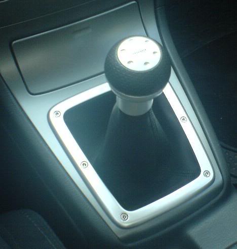

Fifth use another hand in doing this hold the STI Shifter trim in its right place and use a small needle to cut the leather a small holes for the trim screws. Then use a bigger one to make the hole a little bigger. That way when you put the nails, the leather will make a resistant so the nails can come with some force and stay there.
Sixth the put everything back on and you will get the final result.

I also thought of putting some plastic stick to make it harder but I found that I do not want it what I did I found that some of the screw heads cannot go down because of the plastic square so I have to cut in it a little bit to allow for the screw cap to work.
