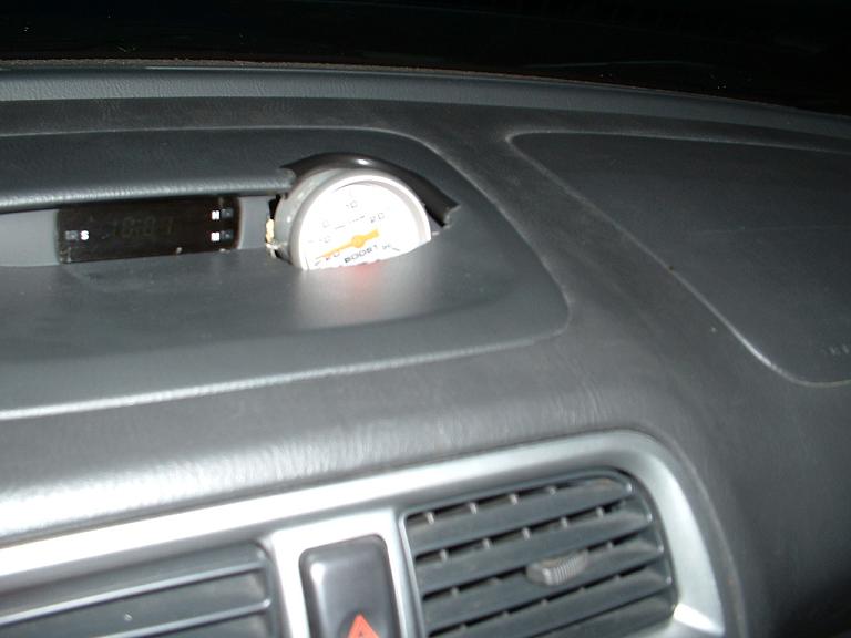

i installed my guage to the right of my clock.

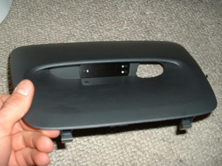

3. pull the clock pannel

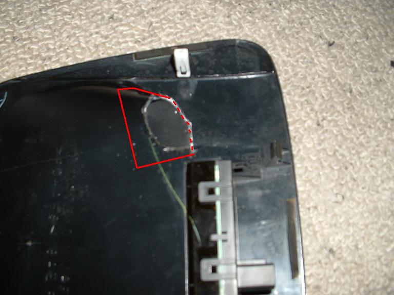

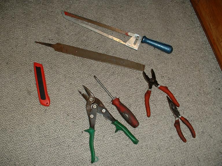

4. cut into the clock pannel. this is where it got sketchy, no one has done this, or atleast documented this, so i was experimenting for all. if anything, i hope someone takes this to the next level and make's theirs look that much better. when cutting the hole, you must consider the shape of the guage. i have a general guide of where to cut. i definitely recoment not cutting too much, like mine, i cut too much and it shows. but i dont care. i started by getting a hole through, using a hack saw. then used a flat head screw driver to pop that apart. when i got to that point, i used my sheet metal cutters for the rest. the file isn't needed. i also used a drill later to pop 2 holes between the plastic brace for the clock.

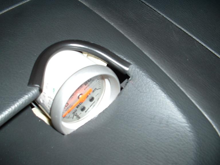

5. at this point, it all should fit, sorta. this is when i mounted it. first i decided on its direction. second i put in the bulb and the boost line. then i mounted it using flexible metal wire which i wraped around one of the inserts that holds the fixture in the dash. i also fished the wire through the holes i drilled and wraped it around the bolts exiting the back of the guage. this acutally held it in place very sturdidly.

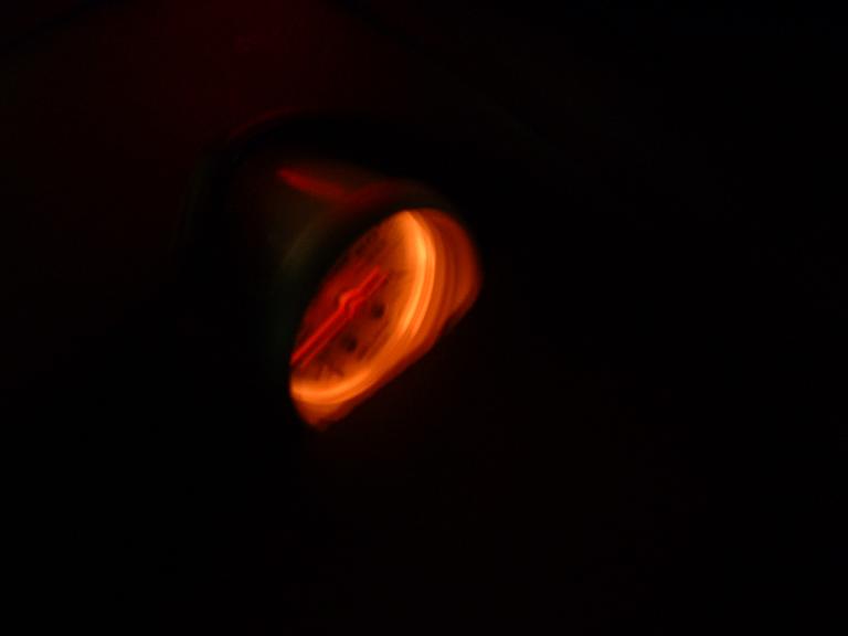

6. for electricity, i pulled out the stereo and fan cluster and underneath that, there is a light for the ash tray. i cut the wires and used that source for power, works perfect and is turned on with the lights too.

If you tilt it upwards a little and put some of that black molding on all the edges, it may help aesthetically

Not a bad job....just a bit out of line of sight for my taste.
Like Legacy05GT said, a little trim ring around the egdes would make it look cleaner.
Definately an original idea. A+ for creativity
