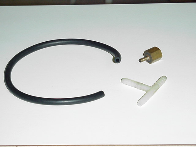

you need to 'T' off of the BOV vacuum line. The autometer gauges comes with a cheap a$$ clear plastic line that uses the compression fitting on the back of the gauge,
... I'd recomend getting 'real' vacuum line from an autoparts store, and buying the 'nipple' fitting for the gauge. You should be able to find the fitting at an autoparts store, ot hardware store.

here's an "example" of what I'm talking about.
of course you need enough vacuum line to reach from the gauge to engine bay, etc.
be sure to zip tie all your connections.
