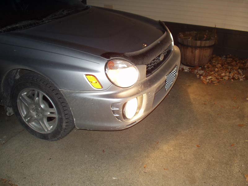

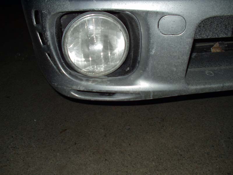

Hey Ryan - there's a lot of posts on the other site about this. I will share my journey down this path.
Options:
Hella 500's - fog or driving. Cheap - only $70/pair and have stock wattage 55w. Which is good - minimal wiring, but only a bit brighter than Stock. I have the fogs, with clear lexan rock guards. I like'm they fill in the headlights and offer some side light. I used the Kartboy mounts.
PIAA 80XT's - 125 Watts of crazy power. Need to re-wire and add the included Relay. It's said these really bright, so much so, you can't use them around traffic. They should be wired to your brights so you can quickly dim them. $260 for the pair (kit). Kartboy mounts are a necessity.
Cibie's are supposedly a very good quality lamp. Hard to find tho' and I couldn't get any confirmation for mounting. Looks like you could go custom. MRT dealers may have more info as MRT offers them for Subies.
One lamp I'm keeping my eye on is the Hella FF200. It comes in both Halogen and HID Xenon. I might get these for aux. driving lamps at grill level for nightime rallys. Stay tuned.
