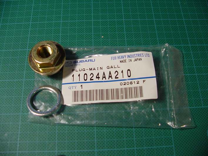

This the right part #?
Yep, that looks like the right part. I do believe the washer is a separate part number also. lemme go check.
Ok, here are the PN.
PLUG-MAIN GALL
11024AA210
GSKT-ALUMINUM
037018200
