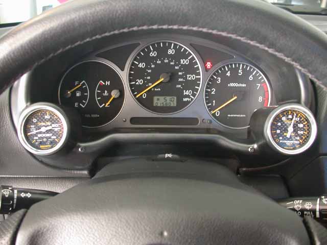

Will look like this...
Autometer carbon fiber BOOST & EGT gauges.
Installed by S-Squared Motorsports.

jlquenga: So, how long did it take for them to install everything? Did you just hand them the guages and the bezel and asked them to install it? How are the guages? Good quality? Night shots? Again, VERY NICE.

Cluster bezel...
I ordered the gauges through them and when all the parts arrived, I just dropped off the car before work and then picked it up afterwards. Can't remember the actual length of installation time. I kinda like how the install matched up with the MOMO steering wheel. The boost gauge had some kind of condensation problem but its been awhile since the last time I noticed it.
