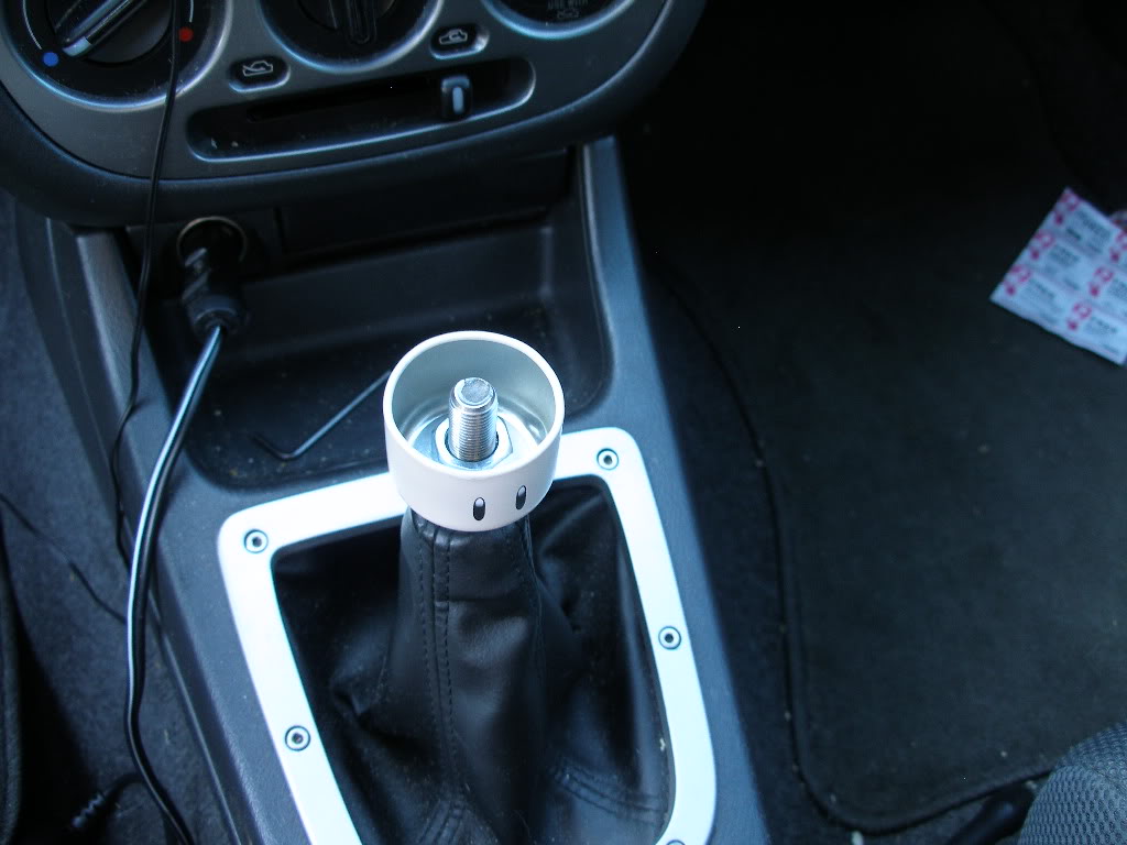

1-UP Shroom Shifter Mod
Super Mario Brothers 1-UP Green Mushroom? Check.
Too much other, more important **** to do? Check.
Useless drill with bad batteries? Check.
Falling victim to my OCD and doing this pointless and awesome mod anyway? Check.
Instructions:
1. Drill 12mm hole in bottom of mushroom.
2. Thread 12mm nut onto threaded end of shifter, followed by a 1" wide, 12mm washer, followed by the mushroom can, another washer, and another nut.
3. Tighten your nuts.
4. Cram your can with heavy brass ***** or whatever gives your stick some weight.
5. Slather the inside of your mushroom helmet with Mighty Putty, and jam it on the shifter.
6. Wait a day for the glue to set, and crustify.
7. Grab your new mushroom tip and ride. And be safe out there, kiddies.
Ahh, now I can go to sleep tonight.
Oy.
