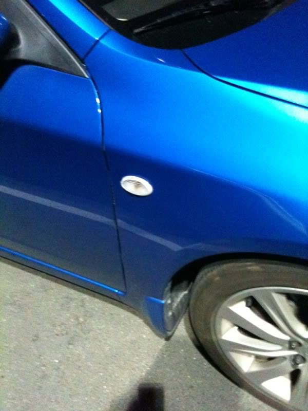

Actually just saw Eric tonight at the Va Jay Jay meet.
Some pics I took.
He said he got them at a local dealership and the wire connectors off ebay.
