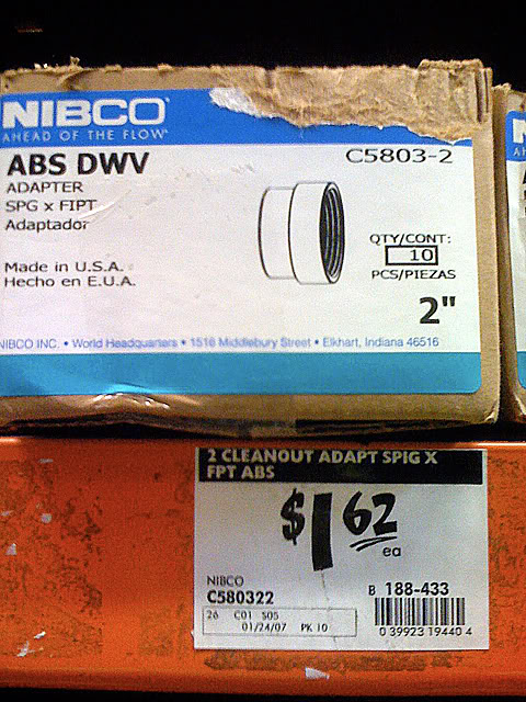

well i was able to find all the things that I needed from Servco at a premium price but at least I'll have what I need to do my project.
I also made a jig to install the Rear Main Oil Seal: 806786040 and picked up something else for a jig for another seal. Here is the details:
Here is a picture of the jigs used and corresponding part numbers that the jigs were used for
This one was used for the 6MT Rear Seal
There were 3 items needed to create the jig that i used
when these are put together they work perfectly and work the same way as the factory one listed in the FSM for EJ251, EJ20, JDM STI EJ207, USDM STI EJ257. A rubber mallet is required as a regular hammer or sledge hammer might be to much force and if you cannot aim and miss the jig you can damage the engine.
