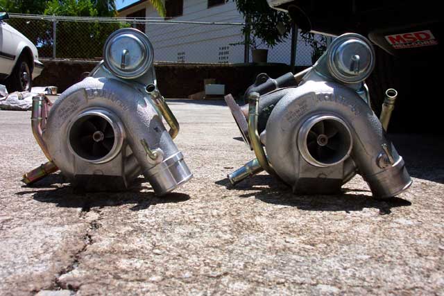

BTW - pix!
(Jon - just throw that torque converter in there!)
VF34 on the left, VF30 on the right.

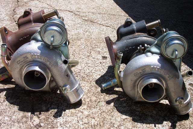

From: The Land of Rocks
Car Info: Turncoat Turbo
34 on the left again...

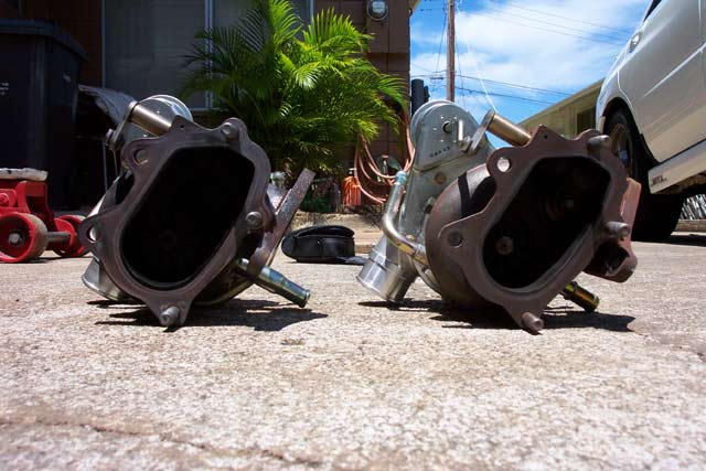

From behind, so VF30 on the left, VF34 on the right.
