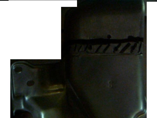

Hey guys just put my up and down pipe on yesterday. It was fairly easy. It took about 5 hours taking my sweet @$$ time. I only ran into one problem, one of the nuts and bolt that connects the passenger side exhaust manifold to the driver side came from the factory mistreaded <---(i think thats the correct word to use. Well any way i was forced to snap the bolt in two to get it off. Which in turn since this is my only car I had to walk 2 miles up the road and back to the city mill in Mililani to get a replacement bolt/nut. I love the new added power from this upgrade. Also does anyone know what part to trim off of the turbo heat shield? Any pics would be great ? Thanks in ahead guys?

Old Apr 14, 2003 | 09:57 AM
mario's Avatar
Posts: 2,859
here u go
cut here
Old Apr 14, 2003 | 10:02 AM
mario's Avatar
Posts: 2,859
here u go
cut here
Attached Thumbnails Up/Down Pipe Install-heatshieldside.jpg

the file i have attached is just to big min requirements are 51200 bytes if u can tell me how to shrink them i can get those pics if u still need them
Old Apr 14, 2003 | 11:16 AM
4080wrx's Avatar
Posts: 6,196
Mario
thanks for trying. dont worry about it i have already foung a good pic on scoobymods.com i think its the same one you tried to post. laterz
