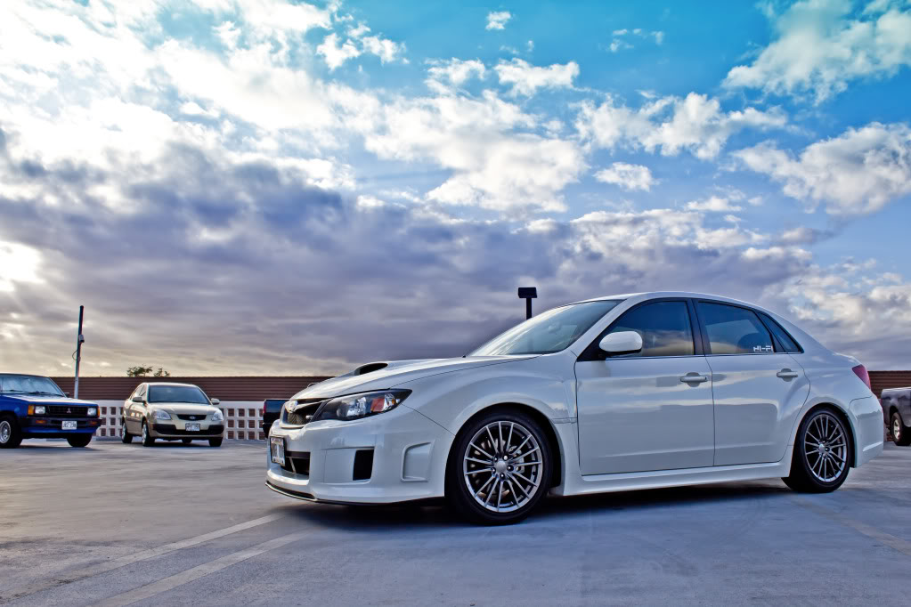

this is the only picture i have with the rce yellows.
RCE Yellows and Bilsteins
18" 255/35 tires.
i had the rear c clip one up from the middle to be level with the front. i think it was a solid fat 2 finger gap all the way around.
i was about to go with h&r springs and the koni yellow inserts but myles at rce said they will be stiff so i wansn't too sure. he was pretty spot on with his recommendations and ride quality. if you get springs make sure to get stuts, or plan to since your's will probably blow fast.
