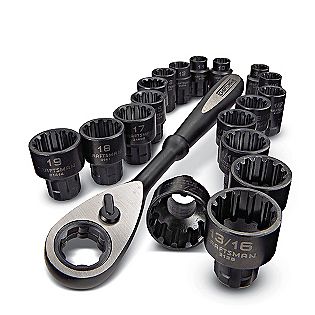

Sears has the new sockets and wrenches that help with rounded nuts...they also have the set as a "pass-through" socket/ratchet...very cool stuff and worth checking out.
Not sure if they have long sockets as it kind of defeats the purpose of the pass through design...so not sure it will work with the type of lugs you have...if they are extended aluminum ones, they may.
They are called:
Universal Max Axess

they make an extension for the pass through set. i have the regular set and the extension is also pass through.

Thanks all. Managed to use a max socket thing at the auto port. They had one.
