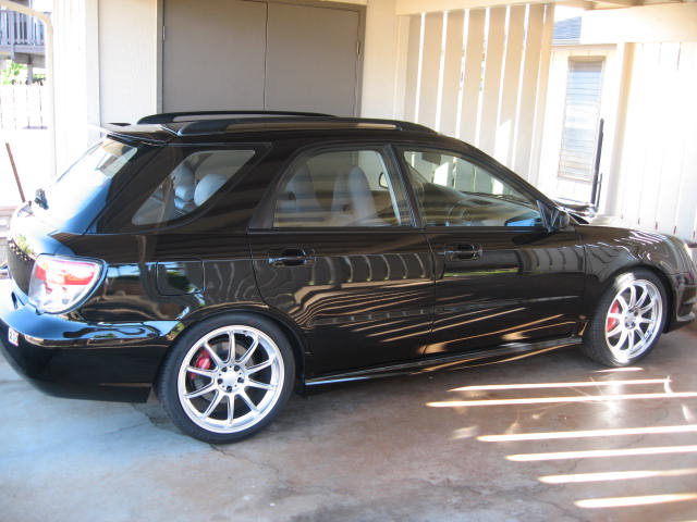

Car Info: Wagons FTW!
I'm running BC coilovers, and they seem to be a little bit harsh (as expected). I am still fooling around with the settings though. At 10 clicks from softest (out of 32), they are not too bad. When I installed them, they look like a good quality product. As far as the rebuilds go, I think you pay them like $95 and they send you a brand new coilover if you ever need it. The rear camber plates are also optional and cost $150 more. You also have the choice of buying a normal strut setup or inverted struts.
I cannot say anything about stance, since I have never seen or ridden in a car with them.
Anyways, here are some pics of the F/R plates and the not_so_slammed_wagon. I didn't mess with the height yet. This is how they came out of the box.
