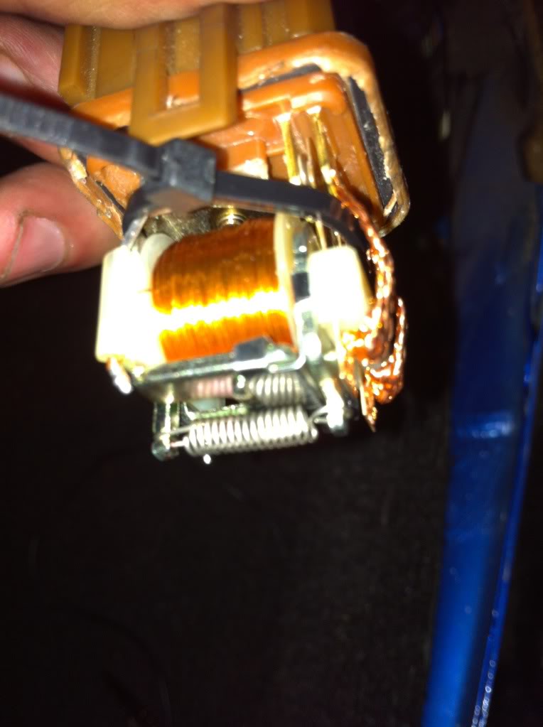

Old May 25, 2012 | 01:27 AM
PSBeachBum's Avatar
Joined: Feb 2011
Posts: 2,106
From: Red Hill
Car Info: my wife crazy with buying parts
and thats how you get it to drive if you need it for an emergency!
