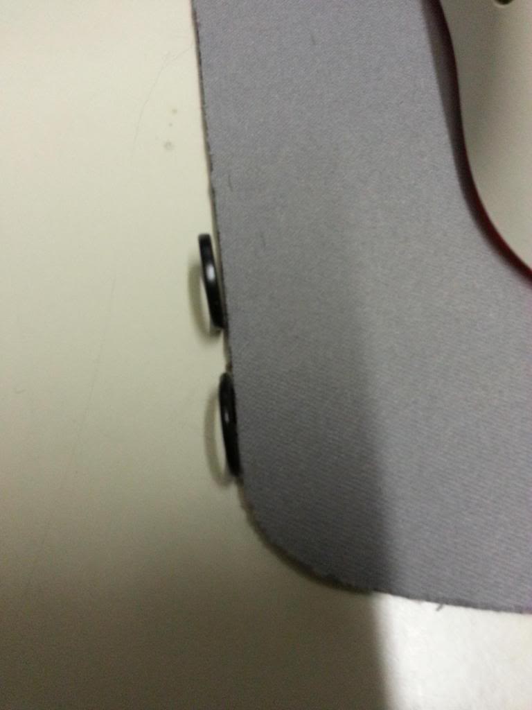

Took me forever, a dozen searches before figuring it out. Here's my write up, hope it helps.
Step 1: Pulled out the the Power steering reservoir and the hoses that are attached on it.
Step 2: Removed the 4x clamps and and pull off the hoses and clean the reservoir
Step 3: Use new 4x clamps (autozone, kregan etc ) and reinstall the hoses with the clamps. Tight but don't go ape shiet on it.
Step 4: Reinstall the Hoses to the return line and feed line.
Step 5: Replacing old power steering O ring (example below of location)
The dealer won't sell you the O ring, they will sell you the entire Power Steering Pump. So instead, you go to the hardware store and pick up this o ring : 5/8" OD x 1/2" ID x 1/16"
Comparison Old and new:
New one on top and old OEM on bottom
Old OEM on top and new one on the bottom
