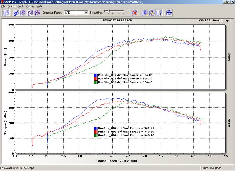

I think it'd be a good idea to start 'classifying' mod posts into separate threads... then it becomes a good resource for research. To contribute.. here is this past weekends 18G data... pretty interesting...
Brent - Blue - FP 18G
Jimi - Red - Blousch 18G
Jess - Green - Deadbolt 18G
interesting to see when full boost hits on the 3 different turbos
Granted that "other mods" will have had a hand in the performance of the turbos, but it's still interesting to see.

Looks like it's a trade off.....HP for Torque. But it all reality there's so many variances in mods, brand of mods, etc... so it makes it so difficult to truly compare. Somebody (I think it was either Elway or Mike) brought up a nice point on Sunday. It would be nice to dyno a stock WRX and a stock STi at Rads to see what a baseline stock pull would look like.

Here is mine...
2004 Sti: 69K Miles
Coscto Premium 92 Octane (Aloha Gas)
Stock bypass valve
Forced Performance 18g TD06-SL2 Turbo, no port, no polish, no coatings applied. 7cm, 2.4"
850cc JECS injectors (Cleaned and flow tested by Deatschwerks)
TGV Deletes
Phenolic TGV Spacers
Walbro Fuel pump
GTSpec V2 Header/Up-Pipe (No wrap or coating)
Cobb Catted DP w/3" flange modification
Greddy Evo2 Catback
APS/WBR hybrid FMIC (APS DR725 Piping with a WBR core)
APS 65mm CAI
TurboXS DTEC
Cobb AP
Exedy Stg1 and ACT Lightened Flywheel
Cobb Lightened Crank Pulley
Put down: 314hp and 362ft-lbs
I wonder what kind of numbers I would have posted with my old 3.5" APS TBE...Brad got some really good numbers with it, but I don't think it was all because of the exhaust...he has some nice supporting mods to enhance his numbers.
BTW: My main objective was to get good numbers while at the same time having a very stealthy exhaust note...the combination of the Cobb catted dp and Greddy EVO2 catback really impressed me. My car is very quiet...much more so than a non-catted dp/EVO2 combo...which most people think is already quiet...

Burt,
thanks for superimposing the 3 characteristic curves of the turbos...it makes analyzing much more clear...
