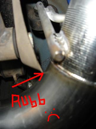

Here's why I need the longer hangers....

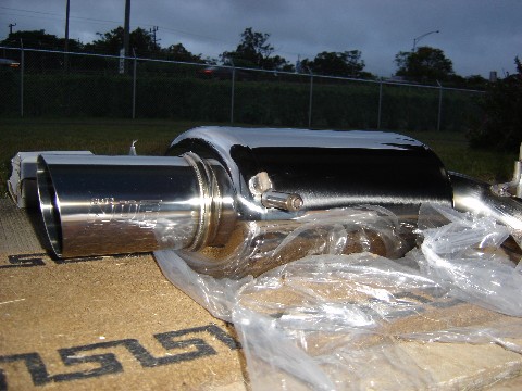

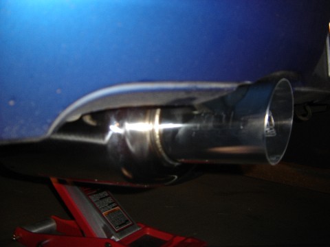

And here's some pics of the wOO spec!!

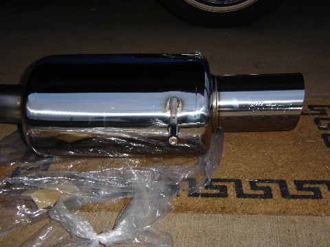

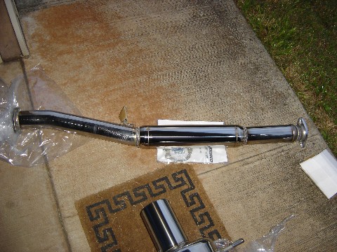

Last ones......

The welding and finish on this thing is f-ing awesome!
BTW Speedgear got like 5 Blitz Nur Spec R's in also today.

Don't know, I'm afraid to drive it right now with the pipe rubbing the rear arm.

I had a problem with my Touring catback because it was a JDM exhaust and the seller didn't make me aware of that fact. Are your hangers in the correct position? If you're finding your hangers pushed back, it means the catback is too short for any USDM downpipe. I had to extend mines by 1 inch or so on the midpipe. After that, I had no rubbing or fitment issues whatsoever. Double check and see if you might have the same problem I did.
- J
