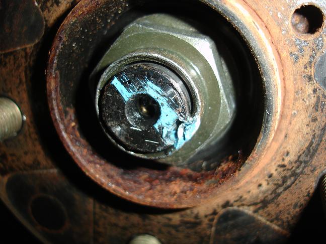

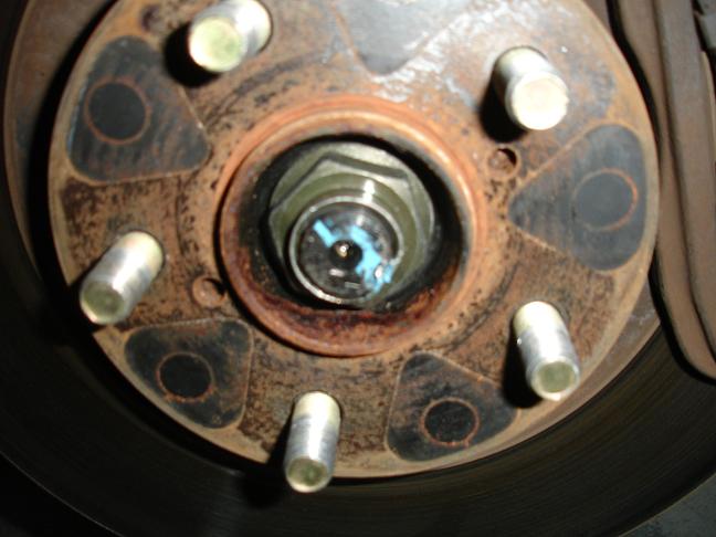

ok, so i got the car on stands and am workin on taking of the rotors. i've never seen this on another car, the driveshaft bolts are dented into a small groove on the drive shaft. is this how its supposed to be (its like that on all four) and if so, do i just bend them back out? i need help quick cause i need to take the rotors in tonight if possible. thanks

ummm... thats called a spindle nut and that is NORMAL
Old Aug 4, 2007 | 09:03 PM
  #43
iNfEk's Avatar
Posts: 10,455
all you do is wiggle the rotor off and make sure that if you're doing the rear rotors that the ebrake is disengaged.
if you cannot just wiggle it off it means that its stuck and you'll need a RUBBER mallet or two fine threaded bolts that will fit into the two holes in the rotor. you'll need to turn them evenly and the rotor will just slip off
Jon

also, WD-40 is your friend as it is also a cleaning agent. spray WD-40 or equivalent into the holes before threading your bolts into it this will help clean out the threads and ease the rotation process. you won't turn to much since the rotor will start to separate form the wheel hub.

so once i get the wheels and calipers off, they should just wiggle off, no more bolt turning? the only other car i did brake work on was my grand am and that was totally different from this car. and my pdf manual is useless....
