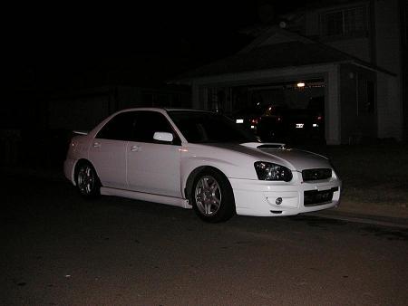

wup guys. i just took some turns tonight with some friends and found that my car needs better handling. i was wondering what i should do next. i already have HKS susp. and strut bars but i need more. soon i will be getting Sti rims. i was thinking about getting front and rear sway bars. what do you guys think.
