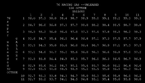

Originally Posted by Private51
can I make 93 by just adding a bottle of octane booster??/
No, but you can use this chart to make 93...but I would run 94. ( This chart sucks I'm looking for the one from 76 right now. But the #'s are the same.)

Old Apr 11, 2005 | 07:53 PM
v rod's Avatar
Posts: 643
From: At work
Car Info: Real Slow
according to the chart above, i had 94 to 95 octane with 100/91 oct mix and ran a 13.1 @ 104 mph.
on 91 **** i ran a 13.7 @ 99 mph. both with same 1.8 60ft. at 2200 ft. elevation.
that's my proof.
