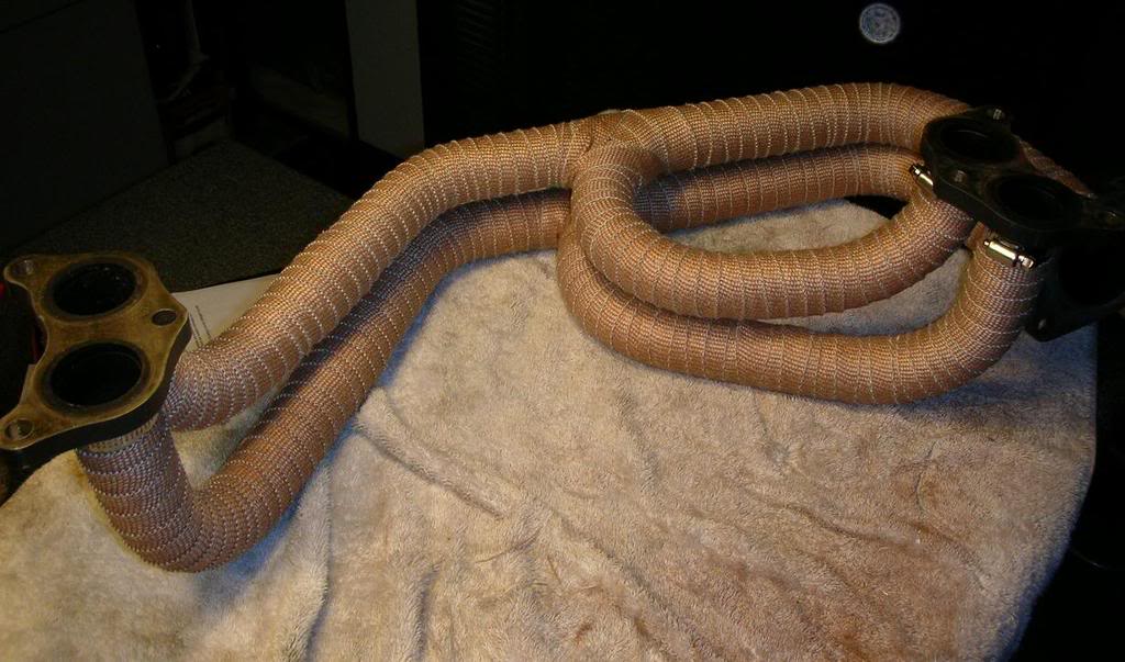

You could go the route i went and send the header and up to swain tech and have a longer lasting thermal barrier that doesn't become a wick if oil spills on it and wont need to be redone in a couple of years. You can read lots of For and against opinions on header wrap. If you are going to wrap them, Go with 2 inch DEI Titanium wrap. Wrapping the up pipe is very straight forward i would suggest the 25 foot roll. The header is a different story. How you plan to wrap it will dictate how much wrap to get. I would suggest wrapping each primary tube individually like in this picture.

Check this site out. it is a wrap calculator. It helps to give you a ballpark idea.
Exhaust and Header Pipe Wrap Calculator | Heatshield Products
