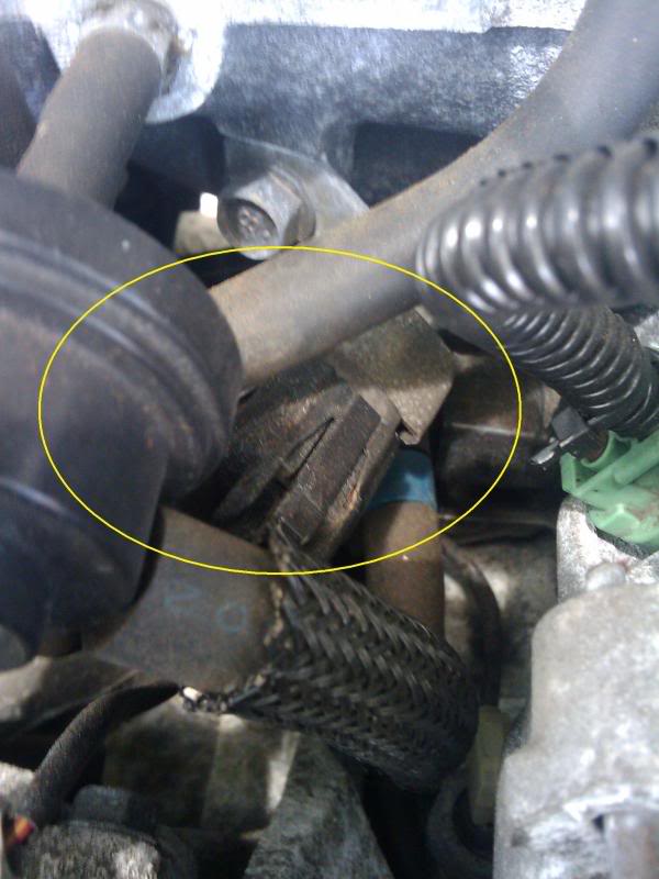

Okay, here is what I have come up with.
Now that I had the benefit of it not being pitch black outside... This little guy is not connected. There is nothing close to it that needs to be connected, so I put it to you.
1st
ZOOOOMM!
Obviously a vacuum line somewhere, and one that I suspect is related to my FPR. Again, runs okay for a little, high idle but no wierd noises or anything this lasts about 2 minutes. Then, BAM, AFR's off the charts and of course starts to limp and stumble.
Where does that line go!

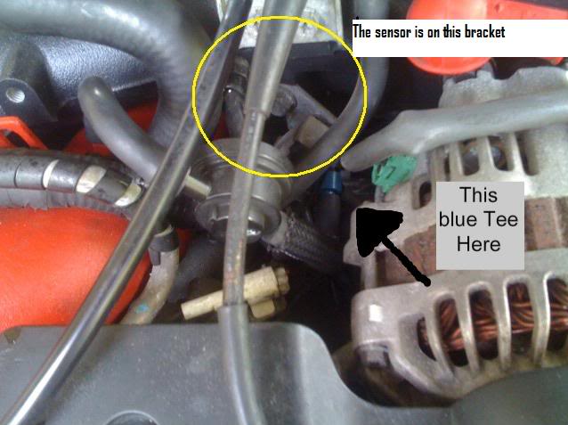

just checked on my engine and it doubles back to a sensor behind the black circle thingy
Old Sep 17, 2009 | 02:58 PM
ds baruuuuu's Avatar
iTrader: (16)
Posts: 3,206
From: kailua
Car Info: 5.4RS
Old Sep 17, 2009 | 03:01 PM
iTrader: (16)
Posts: 3,206
From: kailua
Car Info: 5.4RS
