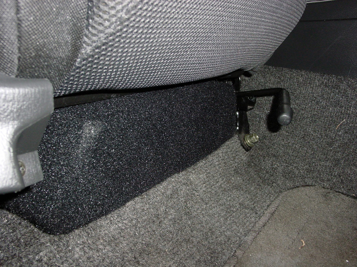

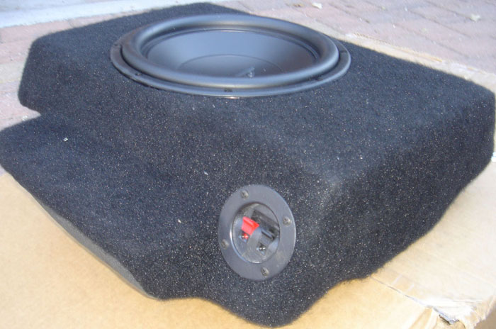

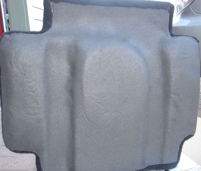

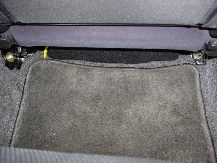

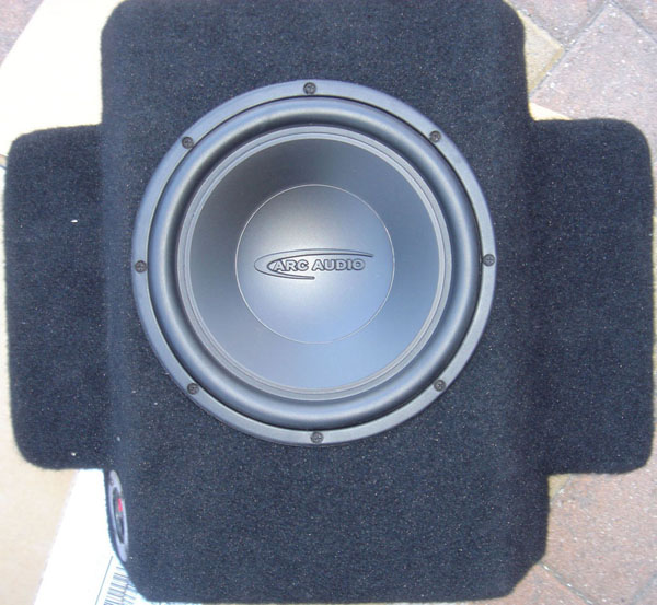

Not sure if he is still working on it or not...as soon as it is done, I will...in the meantime though, I have pics I acquired from NASIOC of someone that sells it over there...RAMMAUDIO
This 10" ARC sub is set up perfectly under the passenger front seat...I
This is not my sub...but a $599 sub off of NASIOC...

AlumaPro does make an 8"...
Originally Posted by oldmansan
A couple of things. Alumapro doesn't make an 8" sub (according to their site).
San
Just went down to the install shop...He had an 8" and 10" out...big difference though...I hope the 10" fits...
He made a mold using my car...he is going to try and get enough volume for a 10", otherwise, it may be an 8" under the seat...
Right now, he says an 8" will fit for sure...and will sound very nice...but will lack the ooomph of the 10"...I'm holding out for the 10"...he will be working on it this week to see what he can do...
I'll let you guys know when it is done...
Brent

Do you know what the sealed volume is? This enclosure is like .4 ft^3 I think...he needs to add a bit of volume to make the 10" sound better.

Depends on the Thiele parameters of the sub. I would think that enclosur is a bit small for most 10" subs. Who knows? Nice looking box, but you couldn't use aftermarket seats.

doesnt the sub itself take away airspace? magnet, frame, etc? i think that spec would be stated with the owners manual of the sub your gonna use, is your box still big enough Brent?

^^^ true dat. when building a sealed box, you must account for the magnet, etc of the sub. so 'box volume'-'magnet'='sealed enclosure'. i guess this is where integrals actually come in handy...

(Height X Width X Depth) / 1728 = Volume in Cubic Feet
You need 0.5 for the Kaption Flat 10 for optimal SPL and 0.8 for optimal Musical.
All taken off of the PDF on the site...I am not that smart

BTW I bet you could give yourself a bit more space by letting the box jut out another inch out the front underside of the seat...nobody really pulls their legs all the way in when they're sitting so maybe you could gain another .035 cubic feet

It does take away from the effective volume of the box...I don't think he added the "wings" as shown in the Rammaudio design...I believe this adds the needed airspace...
