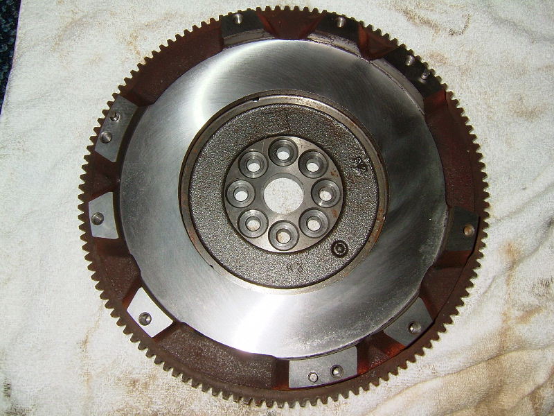

well i decided to get a 05 STI stock clutch since i wanted something reliable that i know won't chatter (alot). but since it's been almost 1 month since i've ordered it i'm looking to getting a exedy sports clutch.
my jdm oem flywheel (sorry don't know what a us sti flywheel looks like) is damn heavy dude. it's about 20lbs or so. this will make it easier for me to engadge my gears but acceleration might be lost?
i'll post a pic
Jon

iNfEk's Avatar
Posts: 10,455
just had it resurfaced
