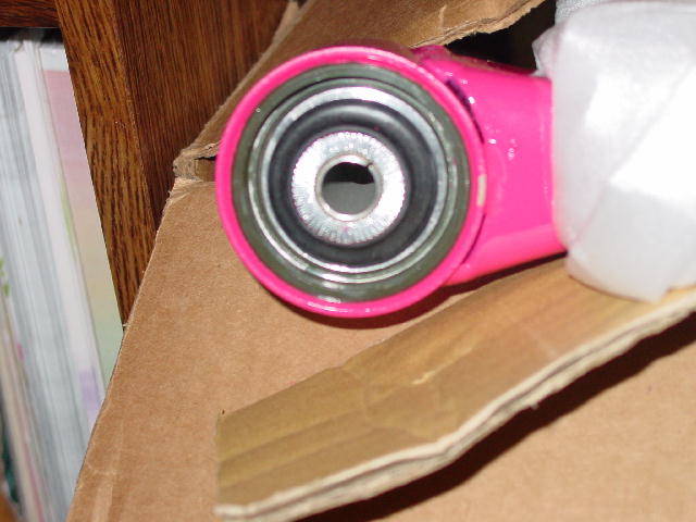

Picture of pillowball bushing from lateral link (pinks):
Attached Thumbnails ATTN: silver satin-pillowball.jpg

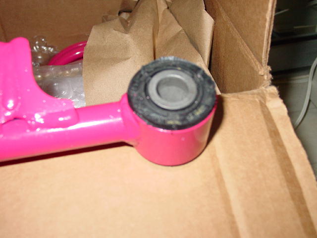

Picture of Group N bushing from other end of the same lateral link
Attached Thumbnails ATTN: silver satin-group-n.jpg

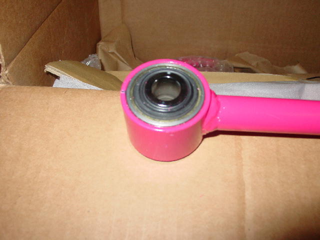

Bushing from trailing link
Attached Thumbnails ATTN: silver satin-rear-link.jpg

Thanks for the pictures!

No problem and you can probably see my pink springs in the background.
