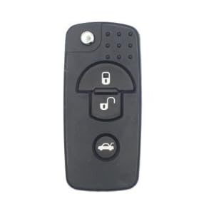

Just wondering if anyone knows anyone with a '10 outback using this key:
- i'd want to ask a favor and see if the clicker portion of the keyfob can be programmed to my '11 sti... the method's documented online, similar to an up/down/up/down/left/right/left/right/select/start/A type of thing. we can re-program it back to your outback first to confirm it works and any mistakes = me paying for key programming. so how bout it!?
(i just want to try this out before buying a key and not being able to use it except as a valet key...)

Possible solution (Subaru All-In-One key fob)
1. Subaru 4-button folding remote key casing - 2.Car Remotes and Transponder Keys > 1).Car Remote keys, Transponder Keys and Key Shell,Rubber > (9).Subaru > 4.Modified folding remote keys Shell
2. Subaru original 4-button folding remote key casing - 2.Car Remotes and Transponder Keys > 1).Car Remote keys, Transponder Keys and Key Shell,Rubber > (9).Subaru > 1.Key Covers
With these you take apart your remote, put everything inside this one, then cut the key. Not sure what to do about the transponder though.

^^ Those are some of the better looking one's ive seen - there's always this soln from amazon, but it's butt ugly imo...
Amazon.com: 2006 06 Subaru Legacy The Switchblade: Key & Remote Combo: Automotive
ive got a unmarked flip key housing headed my way; will do a writeup; its super similar to the iwsti thread posted earlier. I'm planning to hack up my key anyway for my hush hush alarm installation, so might as well give this a shot haha
