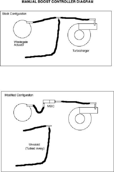

Here is an excerpt from the Vishnu Stage Zero install manual. These are complete instructions for putting in the MBC. Notice there is no removal of the factory Boost controller. I know you have a TXS controller, but an MBC is an MBC is an MBC. You still need a factory EBC as far as I know.
-Greg
-Greg
Now comes the installation. Locate the factory black rubber boost control hose. It runs from the turbocharger’s compressor housing to the turbocharger’s wastegate actuation. In the middle, there is a plastic “T” that runs another rubber line to the boost control solenoid (which is mounted under the little removable plastic panel just below your passenger-side shock tower. All the hoses on that “T” are held in place by little clamps. With a set of needle-nose pliers, pull back all those clamps (3 of them). Now, disconnect the hose from the wastegate actuator nipple (there should be another clamp there too). Next, disconnect the “T” from the hose that runs to the compressor output nipple. At this point, the only hose that is connected is the short hose that runs from the compressor outlet nipple. The rest of the plumbing can now be tucked out of the way. To do this, just fold it back and clamp it under the big plastic toothed clamp that sits near the stock tower. Now, install the MBC by inserting its silicon hose section into the wastegate actuator nipple. The other end (the brass nipple portion) needs to be inserted into the short rubber line that is still connected to the compressor outlet nipple. Get it? If not, check out the diagram at the end of the instructions.

yeah that is cool
ok everything is clear but is there any way you could email or post
a link to the diagram for all that. thank you very much forall the info
