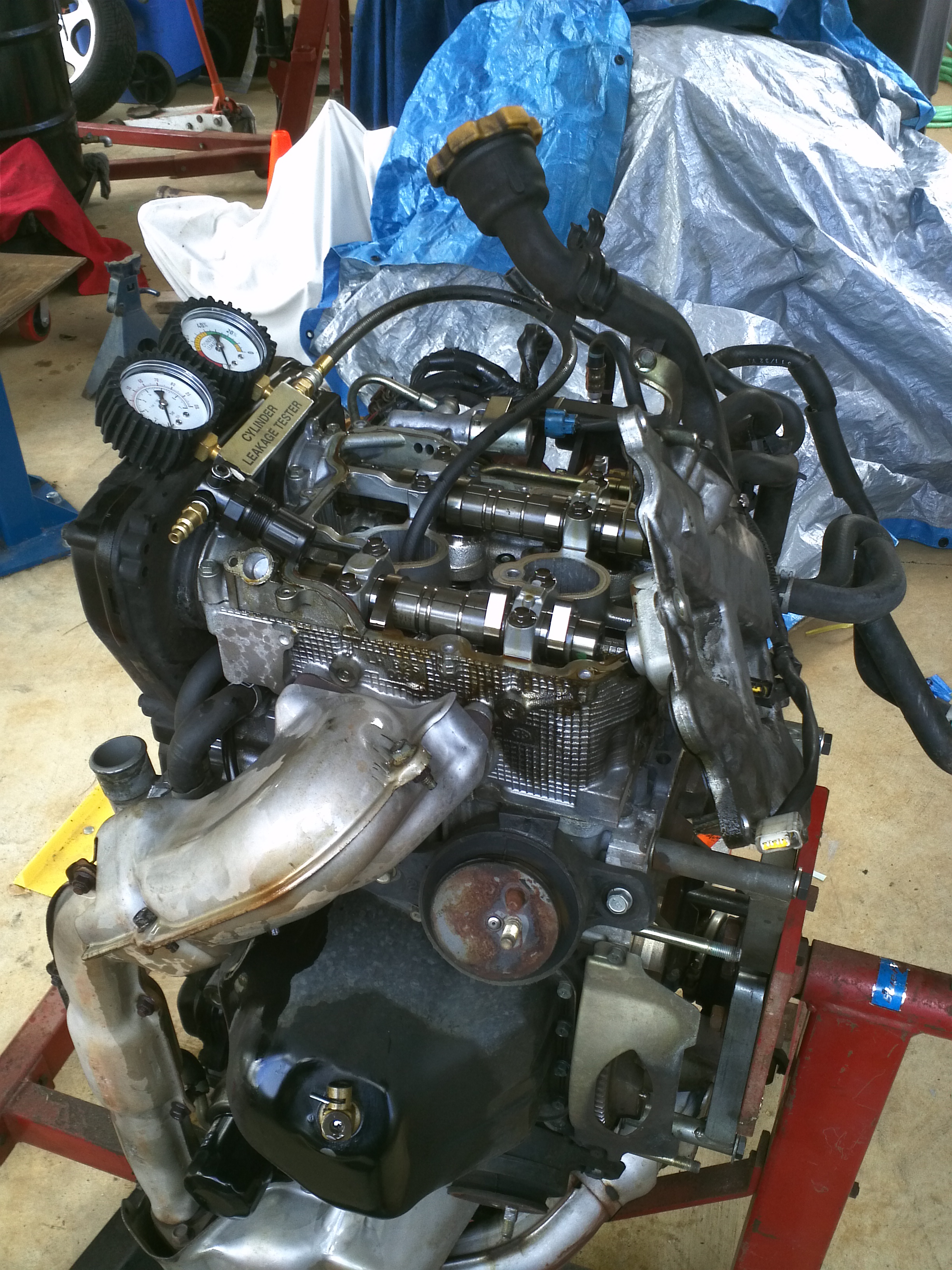

did a cylinder leakage test...
exhaust valves or seats arent holding ...
video
gonna be taking the heads to genuine auto in kailua for repairs...

hmm intersting, this is a stupid no brainer question, but did you messed with the orientation of the crank in an attempt to close the valves? my cylinders were caked with build up and even looked like one of the valves touched. i had good compression on a leak down tester tool like yours tho, tested while hot/ warm in car. i worked on legacy with 100k that needed a valve job and it also showed the same build up. the owner took the heads to Auto Machine Shop Kailua, HI - RK Industries with good price and turn around time. Apparently servco subaru also takes some of their valve jobs to them. ive taken my stuff to snydermachineworks in the past.

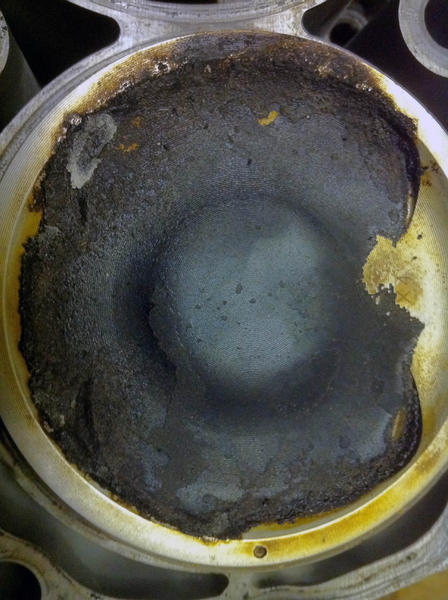

the legacy had a slipped timing belt, not quite related to your situation, but just in reference to the madd build up... this was my piston
i rotated the crank to make sure the lobes werent opening the valves...
i did the same thing to test number 4 cylinder and it came out good....
did i do something wrong?
that is quite some buildup on the piston...suck in some ATF fluid and thatll clear it up ....though dont flood it to clog your cats...but a little at a time....with a nice smoke screen...
lol no just wondering, i also usually have to fight the piston from moving when doing that test and it opens the valves.. they have all kinds of tricks of removing build up... suck in water, seafoam etc... tried a few them and i even had water meth injection but thats what i found...

from the pic...it looks like the carbon deposit was breaking up...
