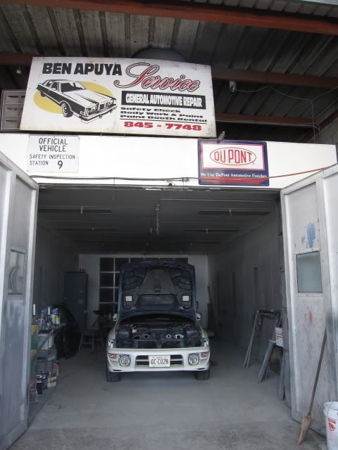

Day 10
-brought the GC to the paint booth to paint the engine bay, should be done by tomorrow afternoon.
Old Nov 21, 2009 | 04:13 PM
  #39
4080wrx's Avatar
Posts: 6,196
Originally Posted by Krang
Could we come check this out? I was thinking tomorrow afternoon if you will be working on it, going to be so sweet when it's done!
tomorrow will probably be a bad day. the GC is getting painted and probably wont be back till late afternoon.
