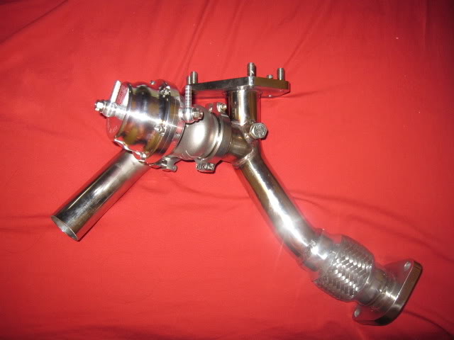

Because scaring people on the road is absolutely necessary!
Going external w/atmospheric dumpl!!!!

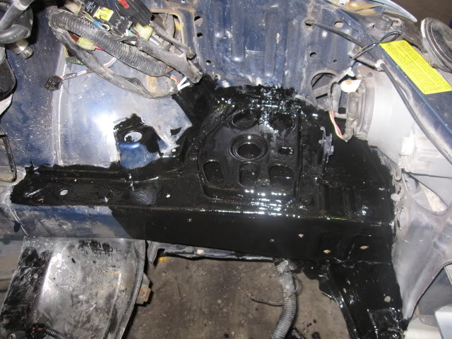

Day 4
-finished up the cleaning, treating and sealing of the rust under the battery tray with Por 15. I plan on painting the whole engine next week to make it look better, kinda funny having a multi colored engine bay.

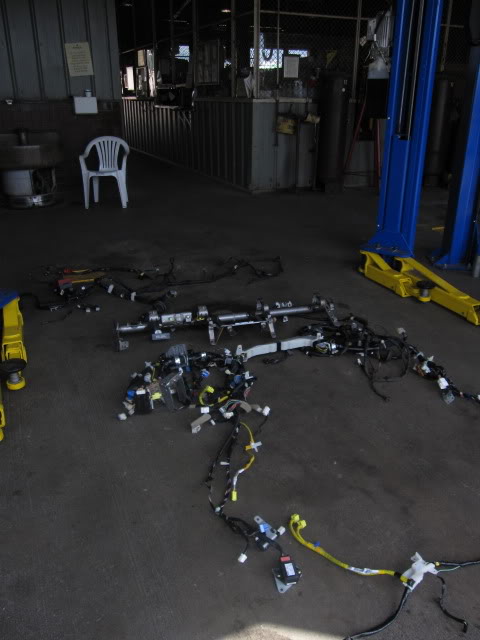

Day 7
-removed the entire wiring harness from the STI (engine, dash, and then some)
-removed dash and dash beam
-removed heater and AC core
