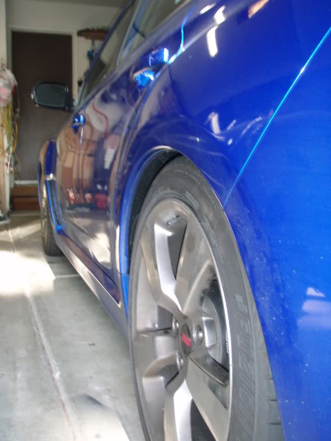

Eibach pro kit.
Great drop. Struts still fine knock on wood..
It's a little lower now

thanks for the pic. the car looks nice, same color as mine.
i was possibly thinking h&r springs, anyone have them on their cars, or have any opinions on them?

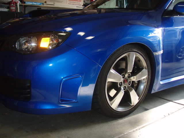

I have megan racing coils on my car, but on previous cars I've had springs from H&R, neuspeed, vogtland, and eibach.
H&R were pretty good, decent drop, and a pretty stiff ride.
not the best of the lot, but vogtland doesnt make springs for subarus so of they ones out there I'd go with H&R.

Thanks for the advice, i dont know when im gettin them but when i do i will post some pics, the drop on your car is nice.
