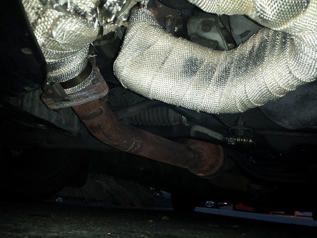

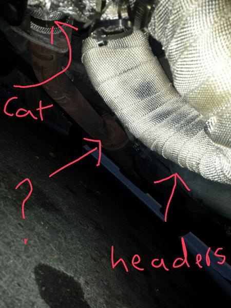

So this is the best I could do since the cars lowered and I'm at work this is from the front of the car my headers are wrapped amd have the cat and o2 sensor attached to them and the second canister is just there with no sensors

Old Jan 17, 2015 | 05:48 PM
silverbullet415's Avatar
Joined: Dec 2007
Posts: 2,898
From: San Francisco
Car Info: 2015 Camaro 2SS/RS 1LE
Looks like a resonator to me, it would have more shielding on it if it was a cat. But I'm not 100%
Old Jan 17, 2015 | 05:59 PM
JourdanWithaU's Avatar
Posts: 19,721
It's a cat. Resonator is further down.
