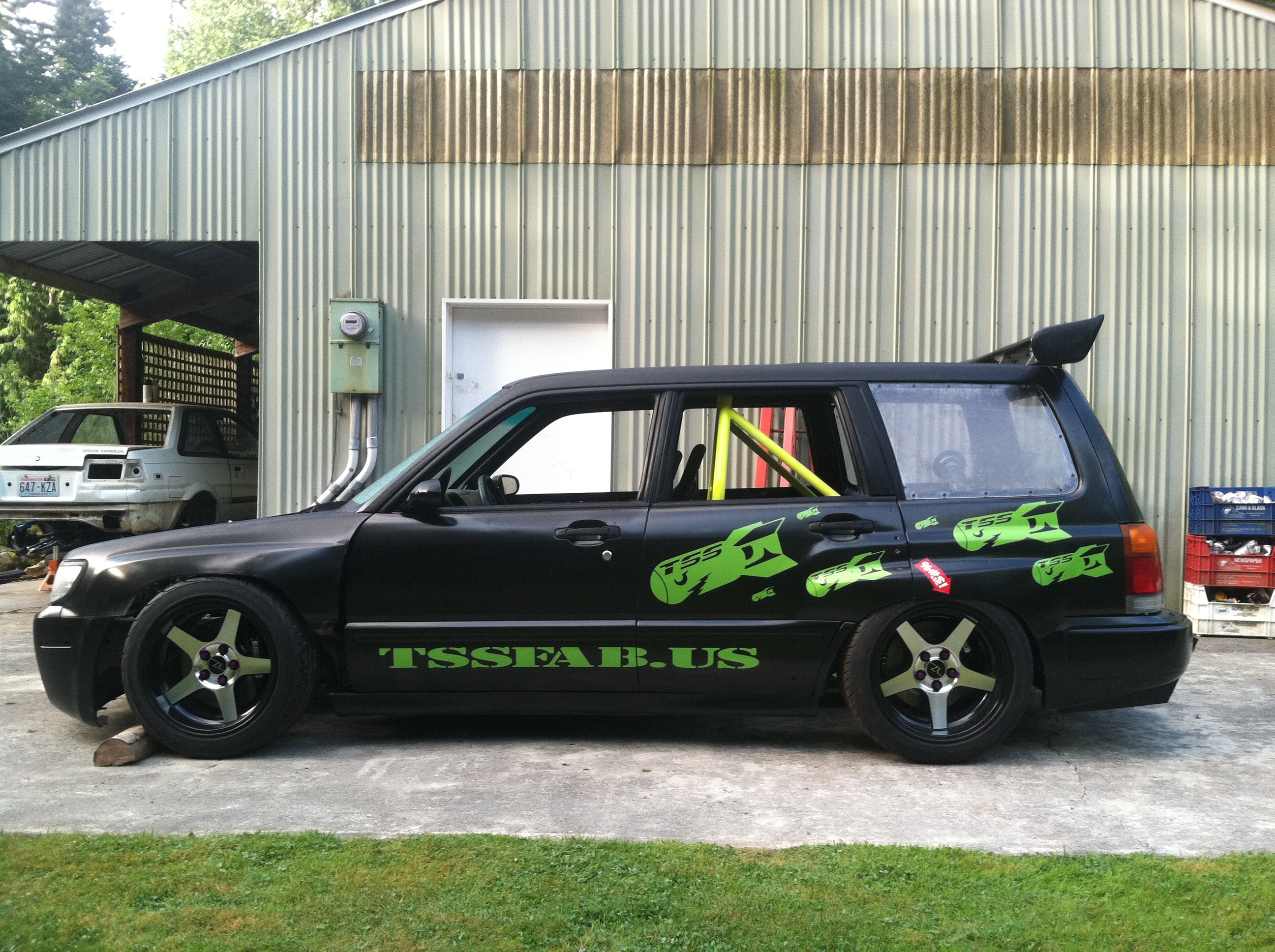

Getting back to your original question, I'm not 100% sure what you can fit under your fender but you will be ~10mm from hitting the strut/spring perch with a 265mm wide (stack height) tire on a 17x7 +53 wheel with no spacer. If you want to stop by and try these wheels and tires and take some measurements you are welcome to PM me.
I also have some 15s with rally tires and 16s with oversize (27") street tires handy to test fit/measure if you'd like.
Here is my favorite forester build thread:
ForeSTAR
he's got a 17x10.5 +20, but he has coilovers and modified fenders so its probably of limited use to you.

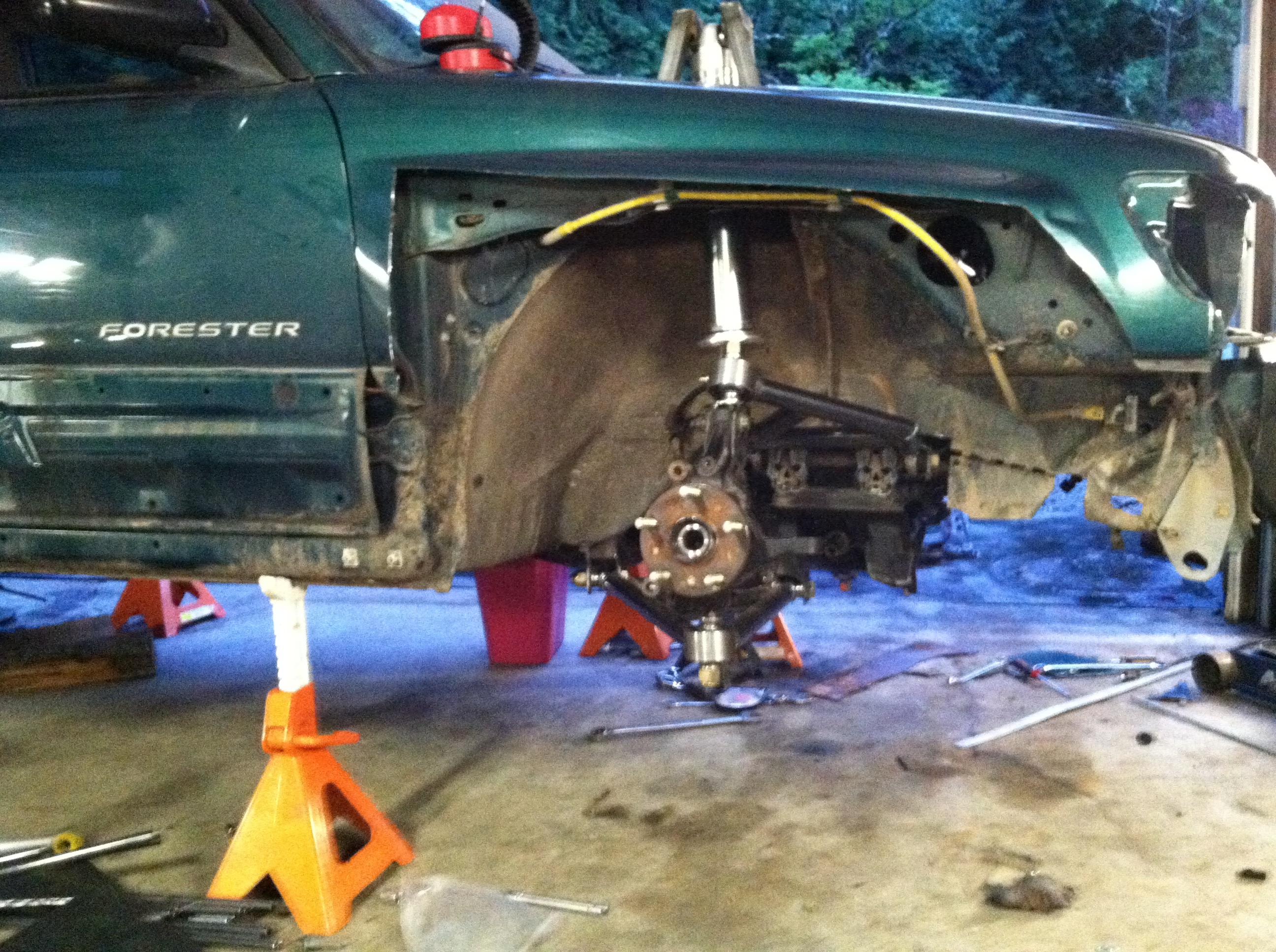

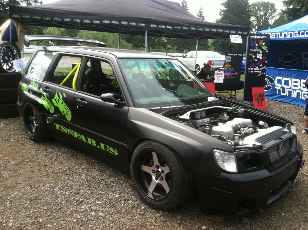

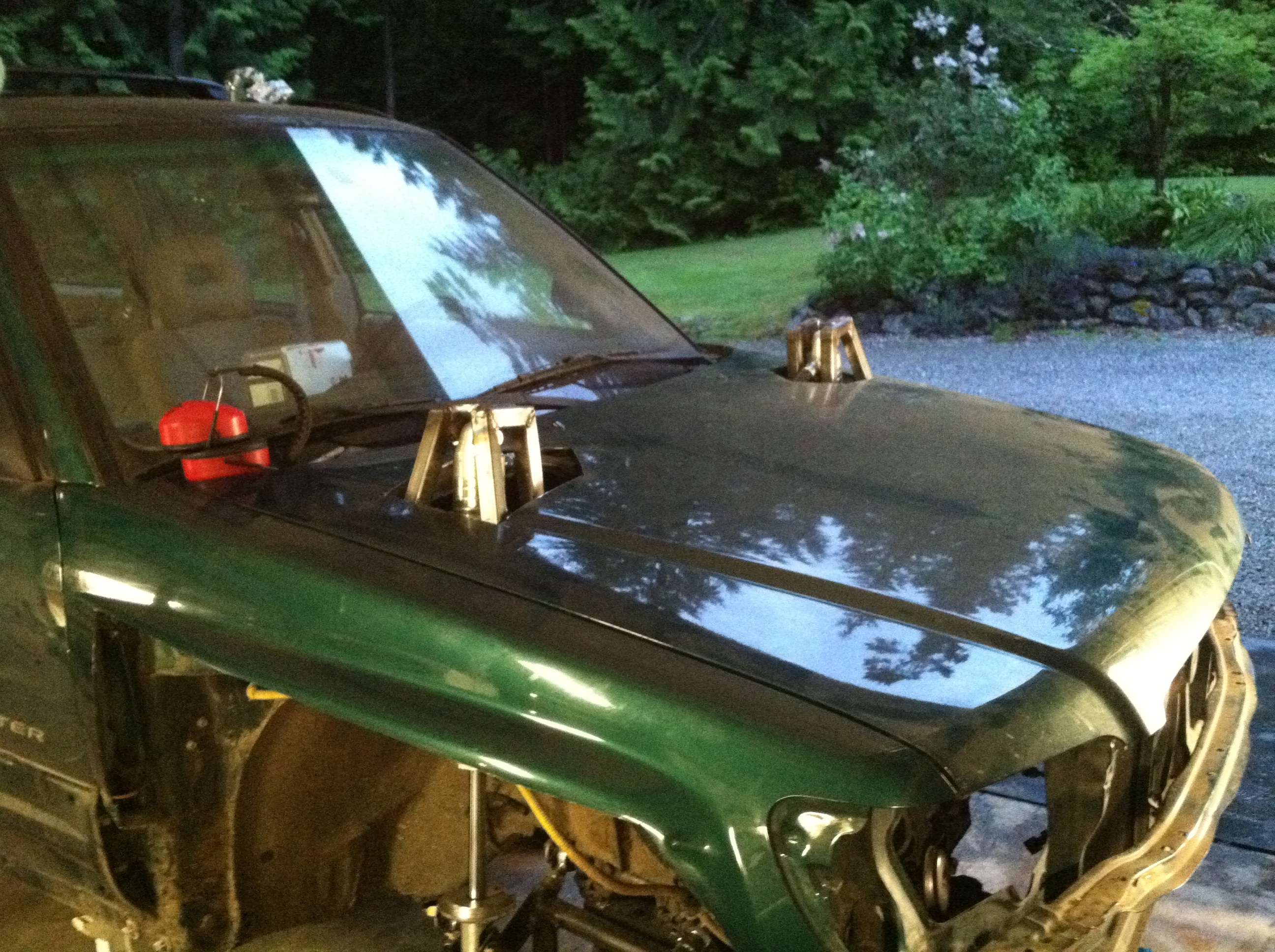

That car is definitely not using "normal" suspension He pretty much fabricated it himself.

Stage 2 with the next one
