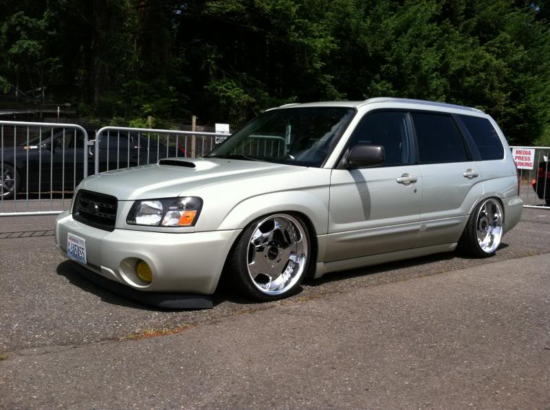

Old Jul 8, 2013 | 01:06 PM
04GG's Avatar
If in doubt, FLAT OUT
Joined: Oct 2010
Posts: 7,046
From: Nor Cal SJ
From another forum. It is bagged
