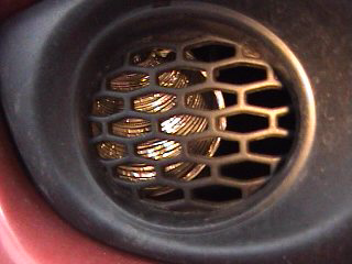

My cold air intake is a dryer hose and a zip tie, i was able to run it right up to the fog light hole. It literally cost 1/16th the price. lol

I did what Mudzilla did too, but I had the hose go down to the original 'brake duct' (02 UKDM or JDM) and had it cut at an angle, to deter water getting in there, also put a fine mesh grill to repel rocks/leaves and water. Works very well for the good price of free .. haha

I did it on a 2.2 99 l wagon. I took off all of those water traps, sound deadener boxes right up to the elbow on the air box. On the elbow there is a slip on plastic snap on piece that the 3 inch dryer hose hooks up to with a zip tie. on the right hand side there are 2 holes on the engine compartment, i ran mine through the first one. I pushed it down till it wouldnt go any more then poped off the fog light cover and pulled it through carfully and wedged it in line with the fog light cover hole. Your going to have to find a way to secure the hose because it rattles quiet a bit. Preformance wise i felt a slight increase in power.

Mudzilla89 - do you have any pics - I think I would like to try that on a MY97 2.2l OBS ?
PM me if you don't want to post them.

I think i can take some pics by friday.

Heres the pics. If you want more i can takem.
Attached Thumbnails Will this intake fit in a 2.2L?-cap0012.bmp   Will this intake fit in a 2.2L?-cap0019.bmp
