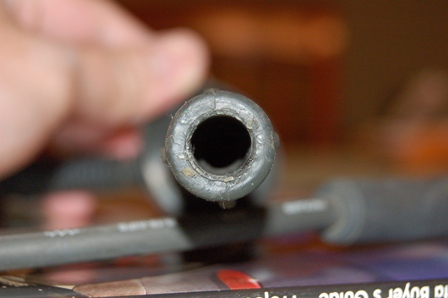

Old Jan 4, 2007 | 09:27 AM
DetailAddict's Avatar
Former Vendor
iTrader: (52)
Posts: 6,912
Car Info: Evo X
Here are some pics of the broken plug wire boot and the connector that came off of it. Also them Bosch plugs that have been in there for about a month...
CEL went away after 2 start after I install the stock plugs and wires. Then this morning I was getting rough idle again and also the CEL!
HELP!
Attached Thumbnails Oil Warning light flickers momentarily + CEL-dsc_0003.jpg   Oil Warning light flickers momentarily + CEL-dsc_0004.jpg   Oil Warning light flickers momentarily + CEL-dsc_0005.jpg   Oil Warning light flickers momentarily + CEL-dsc_0006.jpg   Oil Warning light flickers momentarily + CEL-dsc_0007.jpg
Oil Warning light flickers momentarily + CEL-dsc_0010.jpg   Oil Warning light flickers momentarily + CEL-dsc_0011.jpg   Oil Warning light flickers momentarily + CEL-dsc_0012.jpg   Oil Warning light flickers momentarily + CEL-dsc_0013.jpg   Oil Warning light flickers momentarily + CEL-dsc_0014.jpg
