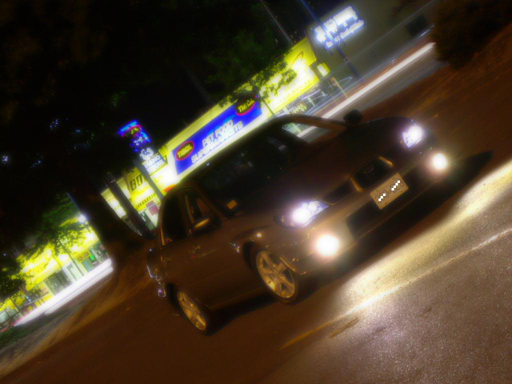

not the best pics, but oh wells:
Low beams - Osram silverstars
Parking lights - white LED
High beams - not shown - stock
Foglights - 55W Tungsram Gold (produces selective-yellow light)
I'll try to get better pics with a better camera
