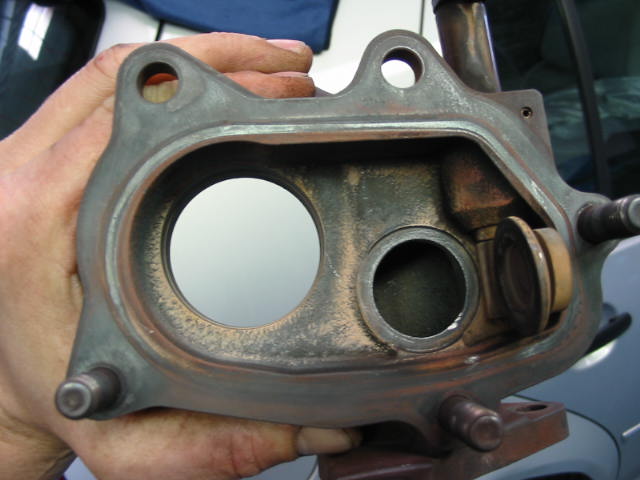

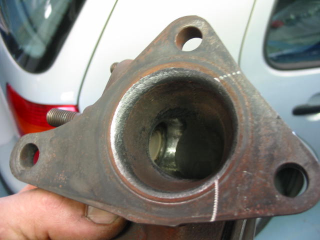

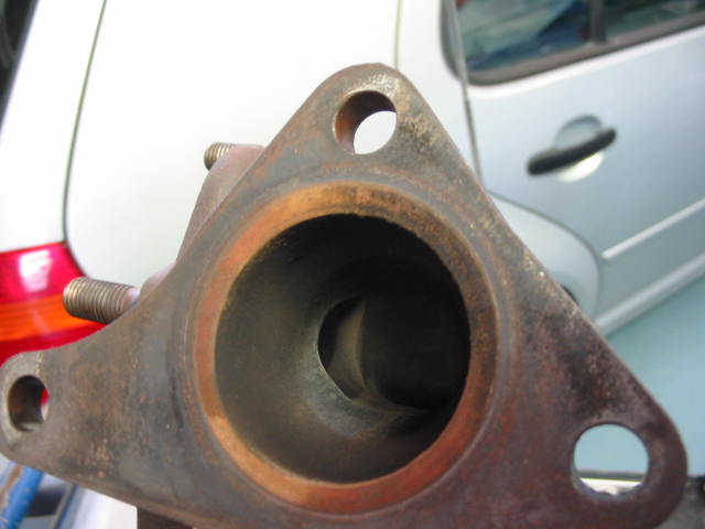

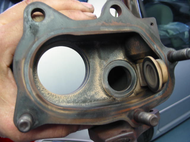

Origami posted by FranckF1
But tonight I made an adjustable actuator arm and got back my pressure by reducing its length by around 5 millimeters.
I'm glad you found a solution.
I did notice that there were a couple of places where the grinder slipped and put marks on the machined surfaces. It's really difficult to grind these areas without slipping because the tool wants to walk across the material. Anyone trying this at home should use caution and go slowly.
FranckF1, thanks for posting those pics. They're very helpful.
