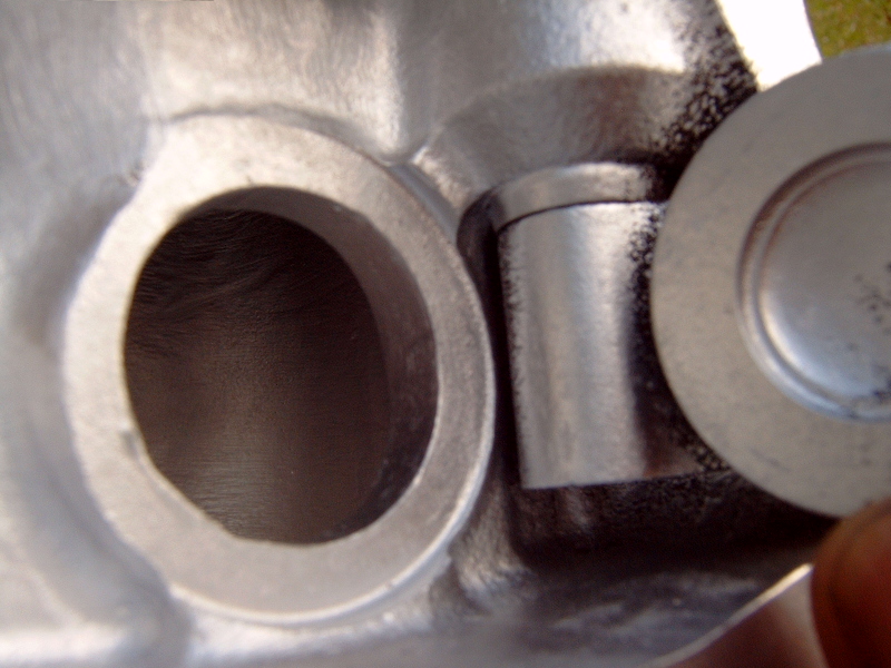

Again, if anyone needs this done, I recommend this guy. He said he'd do it for 30 dollars + buyer pays shipping both ways. He'll mail the exhaust housing back the next day. If you're in the area, you can stop down by his garage and have him do the whole thing in 1.5 hrs. I linked a small website I made to help him out a bit.

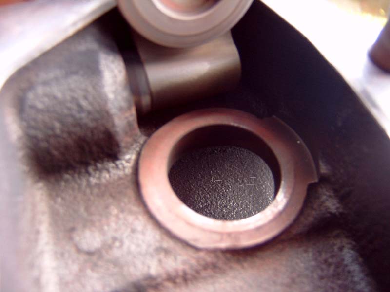

Pretty much what i say if your going to try and do it your self. I say while the wastegate is closed sprat paint it, then remove the pin so and the rod so you can open the wastegate and port inside that hole cool. But thats just what i think, I'll dig up some pics of my turbo's wastegate and let you look and decide for your self. Cool

I'd say take out 70% of the silver sealing lip portion. As you do that make sure you hold the carbide bit (or whatever grider you use) at an angle so you will remove more material beneath the flapper. Widening beneath the wastegatehole can also be done through the section that bolts onto the uppipe.
