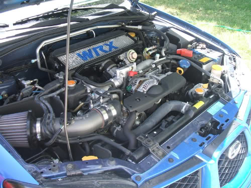

I have SPT. it works fine
i really dont wanna go out and measure but from what i remember it is just a tiny bit bigger than the stock. the hose coupler that connects the 2 is just a tiny bit bigger and the intake side than the other.

i got the heatr shield you can see in the pic. also after install and batt disconnect i had it ran and a/f is all good.
