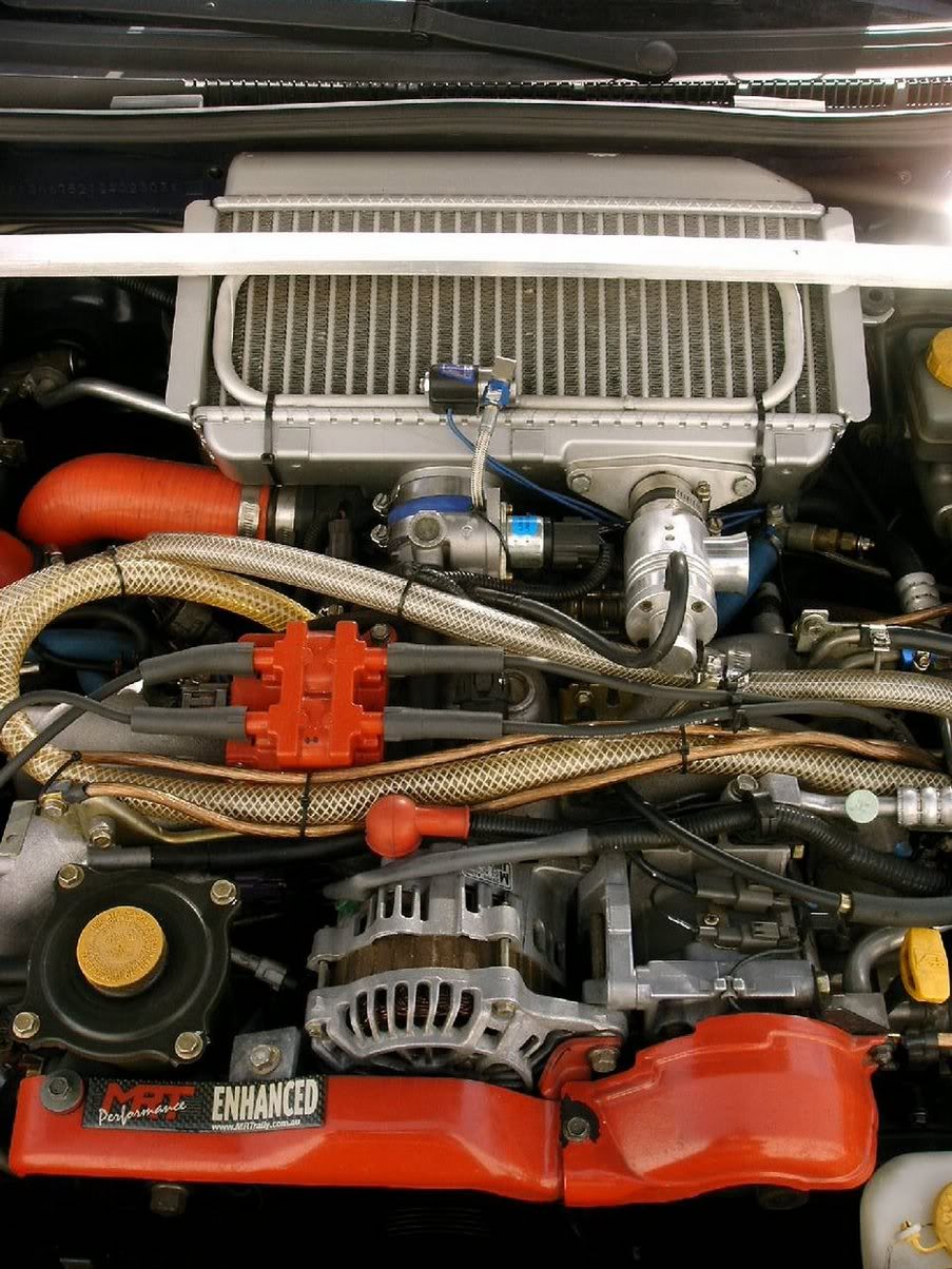

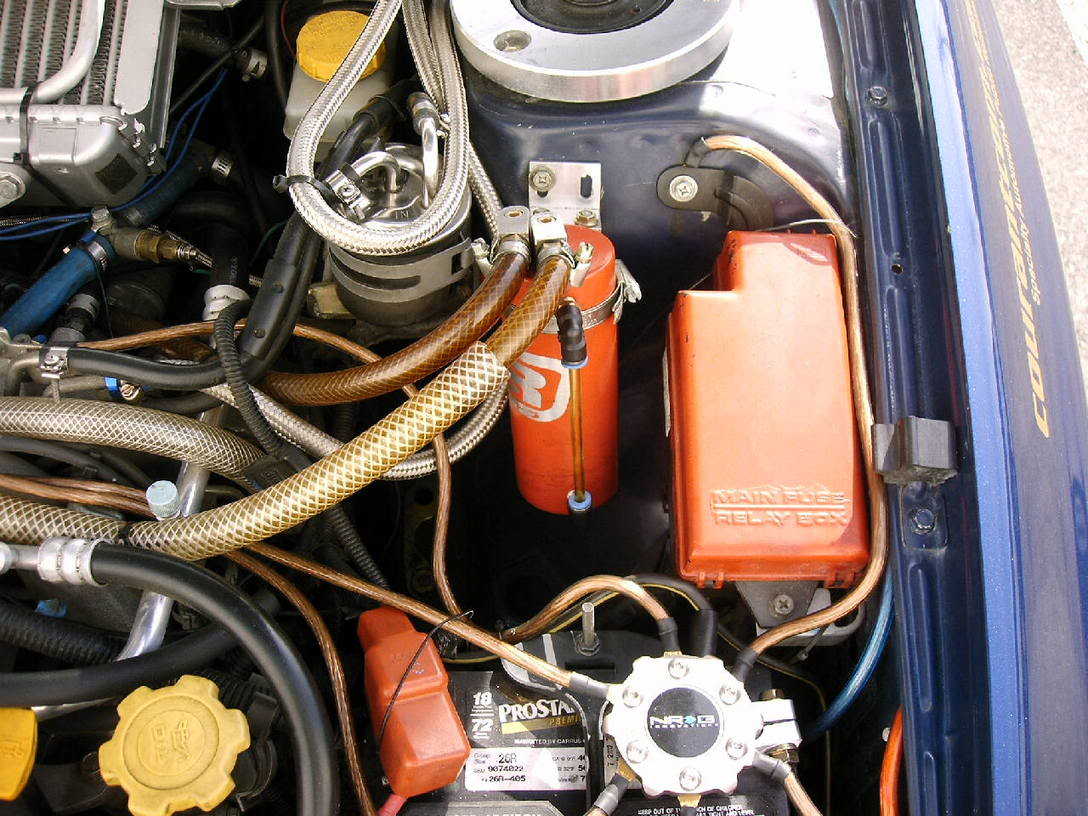

catch cans work I dump mine every oil change
Please excuse the different hose diameters, I was in a bind at 3am in the morning and I've been lazy to change it for the correct size.
