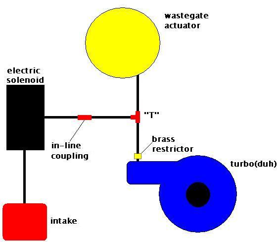

Originally posted by Snowy
Ok an even newer newbe question. What is the 3/16 mod? I haven't heard of this before.
check the pic. The mod is when you replace the inline coupling and "T" with 3/16" ones from any auto parts store. Im still a bit confused about how this mod is supposed to work since the brass restrictor thats tucked into the hose right in front of the turbo is WAY more restrictive than either the oem "T" or coupling, but people here swear it works
Attached Thumbnails noob question about 3/16 mod-turbo.jpg
