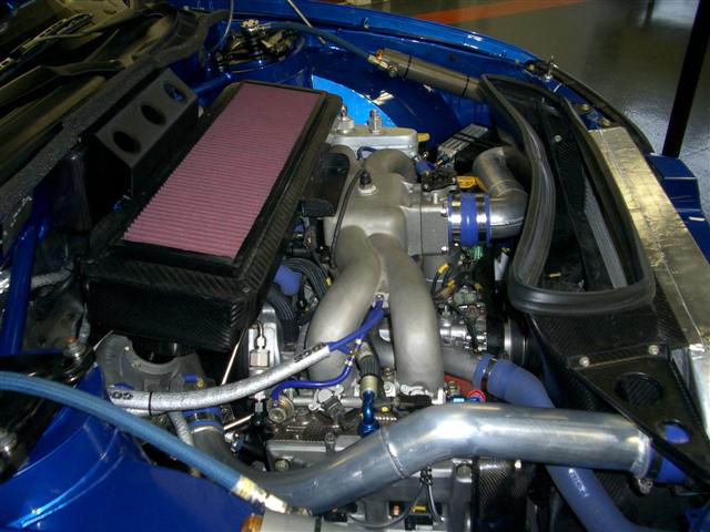

The hood scoop on the WRC car is there only to make the car look like the production car. The actual intake is in the fender, like everybody has been suggesting you do.
Wrong. It's the air intake. =)
See the thread/pics linked by the previous post. That's one bigass air filter!

That said, I too do not belive that actuall WRC cars use the scoop for an intake, lets google it shall we!

well heres your answer, BAN was correct, the scoop on the WRC is NOT functional, here you can see the carbon fiber ducting is actually going to the hood reverse scoop, and this is to pull air up through the front of the intercooler and to act as a secondary air dam for increased downforce, hope that clears it up

Hmm, what's it say on this car? Petter solberg? Hood scoop air intake? Go figure!
Attached Thumbnails fmic and creative intake-swrtic1.jpg   fmic and creative intake-swrtic2.jpg   fmic and creative intake-swrtic3.jpg
