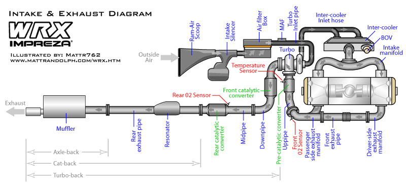

These guys did a great job explaining it; but, here's a picture I think will help a little.
Attached Thumbnails Differences: Axle Back vs Cat Back?-wrx-intake-exhaust-diagram.gif

YES!!! That's perfect! +10 kewlness pts. for awns729
Now I will *right click - save as*

Oh man, that is a great picture. Ok, so I guess I need a cat back if I want to get rid of the resonator (will it make that big of a difference if I just get an axle back?)
I'm thinking I just want to get an axle back so I can keep the sound some what quiet still.
