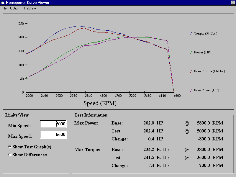

This post it intended to keep the concerned parties informed of some of our initial test results and to give you my driving impressions of the 2006 WRX MT. Take into account that I am not a professional car reviewer. I have not had sufficient time to review any other aspects of the vehicle other than the motor and how it has been tuned. So I will not be able to review or show pictures of the interior, exterior, suspension, etc. PLEASE TAKE INTO ACCOUNT that our dyno is different than other dynos, so comparing our test results to other companies’ 2006 WRX MT test results will not do much good.
I wanted to show you some data that we have recorded on the 2006 Subaru WRX MT. This motor in this vehicle has been compared to the Forester XT so I wanted to first show you the power difference we recorded between the two:
You can see the WRX is making more power across the RPM range which could suggest a different combination of motor hardware, i.e. turbo, heads, cams, static motor compression, etc. or a more aggressive tune. My guess is that the turbo is slightly larger than the one on the Forester XT. Although, this is just a guess…we have not had sufficient time to remove, measure, and compare those parts to verify our guesses. Please don’t get on my case if I am wrong, just giving you my perspective. I believe this to be so because the boost targets are similar for both vehicles, although the WRX makes more power across the entire RPM range and appears to have the ability to hold boost easier at higher RPM.
The fuel curve has more of a taper to it than the stock FXT fuel curve. The FXT fuel curve is close to linear, flat, once it comes out of closed-loop. This vehicle is leaner at lower RPM then richens up as RPM increases. You can also clearly see the closed-loop to open-loop delay. This vehicle had generated approximately 8 lbs. of boost by 3000 RPM where it was still running in CL at a 14.5-14.7 A/F ratio. I could feel this while driving on the street. Below 3000 RPM the vehicle feels like it has turbo lag and it also feels inconsistent. Torque tended to move more below 3000 RPM on the dyno as well. I could feel the car stumble trying to burn that lean on the dyno and on the street. At 3000 RPM the vehicle picks up then takes off at 3500 RPM. This car is deceptively fast. From 3500 RPM on the car drove smooth and accelerated quickly. I drive a 2005 LGT MT most of the time and the WRX felt as if it was going through the gears just as quick but w/o the 3.9 final drive. From the research we were able to complete, it appears that the ’06 WRX has a 3.70 final drive, yet it felt like it accelerated at similar rates as the mildly tuned LGT.

Here comes my thrashing...
Originally Posted by Christian.
My guess is that the turbo is slightly larger than the one on the Forester XT. Take care, Christian.
Well, my guess was wrong. I will be the first to admit it. Now that we have had some more time with this vehicle on the dyno and the street, I am confident saying that the stock 2006 WRX turbo is very similar in size to that of the Forester XT, if not the same size. I say this for several reasons:
1) I could not get torque to hold flat like we normally can on vehicles with sufficient turbos for the VE of the motor, i.e. 2002 WRX, STis.
2) I added 30% of Wastegate Duty Cycle from 4,000 to 6,000 RPM and was only able to muster .2 more psi of relative pressure. This turbo just cannot breath…it is out of air.
3) IAT, measured after the turbo, would significantly jump whenever I tried to raise boost in the higher RPM ranges. Whenever you run turbos out of their efficiency range they turn into flame throwers.
4) Never guess, always complete sufficient R&D before you draw conclusions or even “guess” like I did.
I would also like to let the STi owners relax. The WRX turbo is a smaller turbo. This vehicle is tuned very close to the max from the factory, boost wise at higher RPM. I am confident saying this vehicle will not be able to keep up with the STi. This STi is a technically superior vehicle in many rights.
Here are some initial dyno results from the ECU modifications on an otherwise 100% stock 2006 Subaru WRX MT vs. the stock WRX:
I know this is going to unleash a whole bunch of criticism on me, “no more peak power?!?!”, bla, bla, bla, I have never been a fan of peak quantity of tunes, I more appreciate the quality of a tune. This is what the dyno recorded and they tend to tell the truth. My hopes are that people are able to handle these results. These are initial results…we are not done yet. Please remember that this is through the stock exhaust system as well. I spent extensive time modifying CL/OL, Fuel, Ignition, Dynamic Advance, Boost, & AVCS tables to get these results and to produce a consistent torque curve. Trying to get this vehicle to make any more power in the higher RPM ranges is going to be more than difficult when using the stock turbo. I have mechanical sympathy…I did not want to push the Stage1 set-up much further than stock. I do not want to try and run the turbo beyond its efficiency range just so I can prove I am the dyno champion. We want to make these maps better as well as safe. Please give me some more time so I can follow up on the various Stage2 tests some time next week.
Here is a look at the new fuel curve:
Notice how the CL/OL delay has been eliminated and the peaky torque is no more. The vehicle drives much smoother. We spent extensive time smoothing out the ignition curve to get rid of the initial on throttle and lower RPM jerkiness. We were also able to gain a great area (under the curve) of torque from 2,400 to 5,200 RPM. This also allows for a smoother acceleration and driving experience. The stock 2006 WRX MT drivers should be happy.
We spent time developing and testing maps that would allow higher octane fuels the ability to make more power as well as protecting vehicles from lesser quality fuels. We should be publishing these maps on our web site and supplying them with the 2006 WRX MT AccessPORTs when the ports and maps are finished.
I hope this helps shed some light on the 2006 WRX MTs.

Attached Thumbnails -06wrxmt-stage1-initial-vs-stock.bmp   -06wrxmt-stage1-initial-af.bmp

I wanted to update you with our progress…
Here are some initial results from the Stage2 testing as well as a comparison of our Stage1 vs. our Stage2 mapping.
As you can see the lower RPM torque improvements are substantial. The low RPM drivability is much better as well. Torque still drops with RPM because the stock turbo cannot keep up with the breathing ability of this motor. This brings me to my next point and allows me to give you some good news. We are developing and will be testing different turbo combinations for this vehicle over the next few months. I will keep you updated with our progress.
Something to note, IMO we will not be able to make peak torque at as low of an RPM as we have with the stock turbo configuration. This does not mean that we cannot make more torque for that RPM with an upgraded turbo, just that the laws of physics will not allow peak torque at that low of an RPM and still allow the turbo to flow like a large ball-bearing turbo in the upper RPM range. I am thinking along the lines of power between 3500 RPM to redline with similar spool characteristics as the STi’s VF39 turbo. Please post your responses and requests for turbo upgrades for the 2006 WRX.

Attached Thumbnails -06wrxmt-stage2-initial-vs-stock.bmp   -06wrxmt-stage1-initial-vs-stage2-initial.bmp
